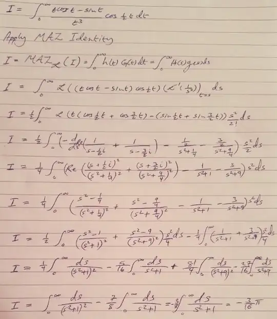

$$\displaystyle{\displaylines{I=\int_{0}^{\infty }\frac{xcos(x)-sin(x)}{x^{2}}.\frac{cos(\frac{x}{2})}{x}dx=\int_{0}^{\infty }\frac{cos(\frac{x}{2})}{x}\left( \frac{cos(x)}{x}-\frac{sin(x)}{x^{2}} \right)dx}}$$ so we have : $$I=\int_{0}^{\infty }\frac{cos(\frac{x}{2})}{x}\left( \frac{cos(x)}{x} -\int_{0}^{1}\frac{cos(xy)}{x}dy\right)dx=\int_{0}^{\infty }\frac{cos(\frac{x}{2})}{x}\left(\int_{0}^{1} (-ysin(yx)) dy\right)dx$$ $$=\int_{0}^{\infty }\frac{-cos(\frac{x}{2})}{2x}\left(\int_{0}^{1} (-ysin(yx)) dy\right)dx$$$$=\displaystyle{\displaylines{\frac{-1}{2}\int_{0}^{1}y\int_{0}^{\infty }\frac{sin(y+\frac{1}{2})x-sin(\frac{1}{2}-y)x}{x}dxdy}}$$ Hence $$\displaystyle{\displaylines{I=\frac{-1}{2}\left[\int_{0}^{\frac{1}{2}} \left( y(\frac{\pi}{2}-\frac{\pi}{2}) \right)dy+\int_{\frac{1}{2}}^{1}\left(y(\frac{\pi}{2}+\frac{\pi}{2}) \right) dy\right]}}$$
$$\displaystyle{\displaylines{=\frac{-1}{2}\int_{\frac{1}{2}}^{1}\pi y dy=\frac{-3\pi}{16}}}$$
This is very old exercise has been evaluated by applying MAZ Identity
    What's MAZ identity ?. Do you have any reference for it ?. – Felix Marin Mar 02 '21 at 08:51
    @felixmarin I had never heard of it until today (saw it in a video, tried to find a reference, found this problem instead), but it appears to be the identity used in the answer of Martin Gales. If $K(x,y)=\overline{K(y,x)}$, and we define an integral transform by integrating against K, then if $f(x)K(x,y)\overline{g(y)}$ is integrable, we can apply Fubini. Since the Laplace kernel is real, bounded, and symmetric, it defines a self adjoint operator between appropriate spaces, but can be applied in a wider context where everything still makes sense. – Aaron Mar 08 '21 at 01:12
    @uniquesailor Can you please enlighten us all by telling us where does the name "Maz" come from and what does it stand for? It is a person's name or some sort of acronym? – omegadot Jul 16 '21 at 03:16
  • @Aaron, do you mean Parseval's theorem by $K(x,y)=\overline{K(y,x)}$? – MathArt Mar 28 '24 at 08:50
    @MathArt No, I mean exactly what I wrote. $K(x,y)$ is a complex valued function that we are integrating against for our integral transform, and, so if f(x) is a function, we get $T(f)(y)=\int f(x)K(x,y)dx$, and if you have the inner product given by $<f,g>=\int f\overline{g}d\mu$, then the condition that the transform is self adjoint is that $K(x,y)=\overline{K(y,x)}$. This has nothing to do with Parseval's theorem. Other than the fact that the Fourier transform is an example of an integral transform, this has nothing to do with Fourier at all. – Aaron Mar 28 '24 at 09:45
