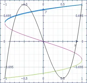

Update:
By simple trigonometry, the function is in fact the three-branched inverse of the cubic $4x^3-3x$.
If a good approximate solution can be estimated, maybe a few Newton's iterations can quickly polish. The blue branch is close to
$$\sqrt{\dfrac{x+1}8}+\frac12.$$
