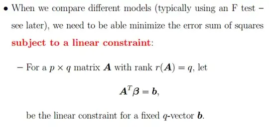

We are in the 3rd week of this class so we have only covered the basics. I don't have much experience in this field and the problem statement is not too elaborate so I need some perspective. I have researched and all the information I can find is on Constrained Linear Models, some have what they call "linear constraints", like here:
Then again, it says "When we compare different models". Am I supposed to solve a problem with a linear constraint or is that something completely different? Any tips to get me started would be highly appreciated.
