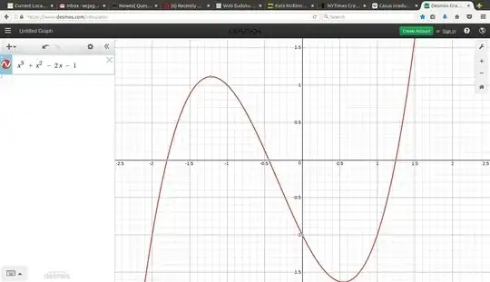

ADDED: I remembered where I had seen this before, with lower degree; let $\alpha \neq 1$ be a seventh root of unity, $$ \alpha^7 = 1, $$ and take $$ \gamma = \alpha + \alpha^6, $$ $$ \gamma^2 = \alpha^2 + 2 + \alpha^5, $$ $$ \gamma^3 = \alpha^3 + 3 \alpha + 3 \alpha^6 + \alpha^4. $$ Therefore $$ \gamma^3 + \gamma^2 - 2 \gamma - 1 = \alpha^3 + \alpha^2 + \alpha + 1 + \alpha^6 + \alpha^5 + \alpha^4 = 0 $$ This is a cubic with three irrational roots, and is https://en.wikipedia.org/wiki/Casus_irreducibilis

Easy enough to find cubic monics of the form $x^3 + x^2 + b x + c$ with no rational roots and square discriminant, so that the Galois group is $\mathbb Z_3.$ Not that there is no loss in having either that form or $x^3 + bx + c,$ as a pure (integer) translation changes the coefficient of $x^2$ by $3,$ and the differences between $x^3 + x^2 + b x + c$ and $x^3 - x^2 + b x - c$ are not important for this problem.
