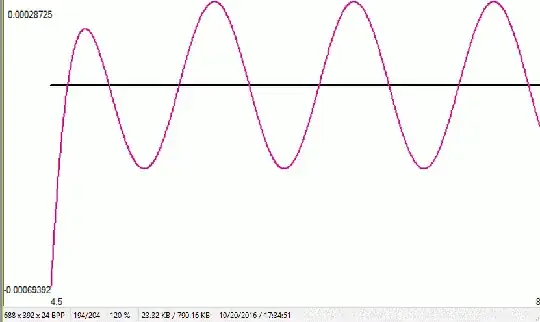

Here are two graphs of g(z), from -1 to 8, and another showing the asymptotic behavior. The first zero crossing occurs at x1~=4.61986470857217, sexp_2(x1)~=4.78924742892085E72 followed by x2~=4.91660. subsequent zero crossings occur at x~=5.41812556847432+0.5n, for integers n.

g(z) from 4.5 to 8

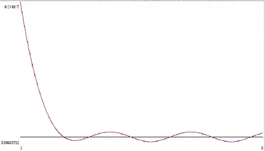

This is a graph of $g(x)$ with x ranging from 3..6, showing the 50% duty cycle as gets arbitrarily large.
graph of g(x) from 3..6
