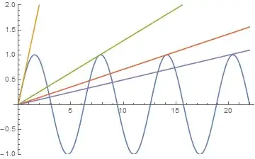

I will consider only the case $0<m<1$ and positive solutions. Look at the following picture: enter image description here
There is a sequence $1=m_1>m_2>m_3>\dots$ such that the line $y=m_kx$ is tangent to the graph of $\sin x$ at a point $x_k\in(2\,k\,\pi,2\,k\,\pi+1)$. The equation $\sin x=m\,x$ has
  • $2\,k-1$ solutions if $m=m_k$
  • $2\,k$ solutions if $m_k<m<m_{k+1}$
The values of $x_k$, $m_k$ are the solutions obf the system $$ \sin x=m\,x,\quad\cos x=m. $$ The first values of $m_k$ are $m_1=1$, $m_2=0.128375$, $m_3=0.0709135$, $m_4=0.0490296$.
