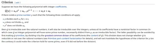

From Wikipedia page: Eisenstein Criterion:
I thought the irreducibility in $\mathbb Q[X]$ automatically implies the irreducibility in $\mathbb Z[X]$, because $\mathbb Z\subset \mathbb Q$.
Could someone give a counterexample of a polynomial $f\in \mathbb Z[X]$ which is irreducible over $\mathbb Q[X]$ and reducible over $\mathbb Z[X]$?

If you read that wikipedia article, they say exactly this: "(in which case $Q$ as integer polynomial will have some prime number, necessarily distinct from $p$, as an irreducible factor)"
