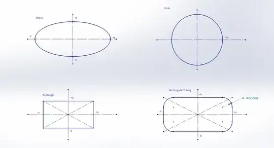

I'm working on a problem where I need the parametric equation for a complex shape.
different shapes: circle, eclipse, rectangle, tube
Parametric equation of a circle:
 x = a * cos θ
 y = a * sin θ
Parametric equation of an ellipse:
 x = a * cos θ
 y = b * sin θ
Parametric equation of a rectangle, reference:
 x = a * (|cos θ| * cos θ + |sin θ| * sin θ)
 y = b * (|cos θ| * cos θ - |sin θ| * sin θ)
Parametric equation of a tubing with radius at the corners:
??  inputs = a, b and material thickness (i.e. corner radius = 2 * thickness)
The shape I'm trying to model is hollow rectangular steel tubing. As manufactured, hollow steel tubing has a 'corner' radius = two times material thickness, per standard ASTM A500-10.
Ultimately I'm working on a free tube notching calculator and pattern generator. I'd like to add a feature for rectangular tubing to rectangular tubing. I'm really relying on the parametric angular input to complete the model. I'm pulling out my hair trying to develop a functional parametric equation for the hollow steel outer shape (with radius at each corner) to use in my Descriptive Geometry analysis.
Any recommendations on how to proceed here to obtain a parametrized form of a rectangle with sized corner radius?

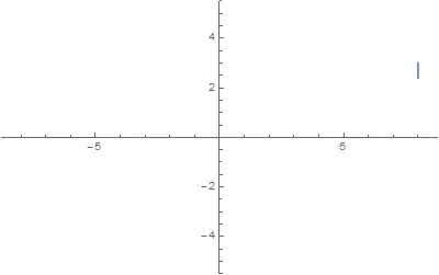

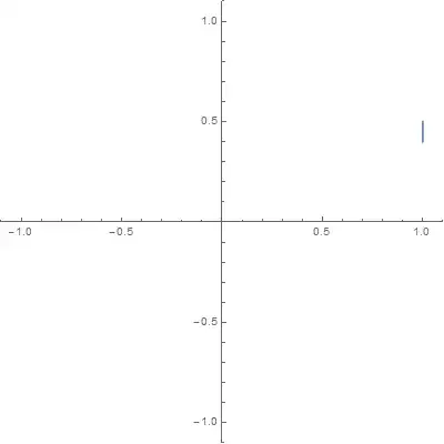

Piecewise Solution
$a$ is the horizontal "radius" of the pipe. I.e. the horizontal distance between the two sides is $2a$.
$b$ is the vertical "radius" of the pipe. I.e. the vertical distance between the two sides is $2b$.
$r$ is the radius of the corner pieces.
$$f(t)=\begin{cases} \{a,-(b-r)(2t-1)\} & 0\le t\le 1 \\ \left\{a-r+r \cos \left(\frac{1}{2} \pi (t-1)\right),-b+r-r \sin \left(\frac{1}{2} \pi (t-1)\right)\right\} & 1<t\le 2 \\ \{-(a-r) (2t-5),-b\} & 2<t\le 3 \\ \left\{-a+r-r \sin \left(\frac{1}{2} \pi (t-3)\right),-b+r-r \cos \left(\frac{1}{2} \pi (t-3)\right)\right\} & 3<t\le 4 \\ \{-a,(b-r) (2t-9)\} & 4<t\le 5 \\ \left\{-a+r-r \cos \left(\frac{1}{2} \pi (t-5)\right),b-r+r \sin \left(\frac{1}{2} \pi (t-5)\right)\right\} & 5<t\le 6 \\ \{(a-r) (2t-13),b\} & 6<t\le 7 \\ \left\{a-r+r \sin \left(\frac{1}{2} \pi (t-7)\right),b-r+r \cos \left(\frac{1}{2} \pi (t-7)\right)\right\} & 7<t\le 8 \end{cases}$$
This varies the parameter $t$ over the range $[0,8]$. If a range of $[0,2\pi]$ is required then just apply a scaling factor: $g(t)=f\left(\frac{4t}{\pi}\right)$
Image $(a=1,b=1,r=0.5)$
Image $(a=8,b=5,r=2)$

  • Ian, At first glance, pretty awesome work. I'm going to need a day to digest this, before accepting if that's okay? Is that a Matlab --> gif image? That -2rt characteristic blows me away with its simplicity. – zipzit Oct 08 '16 at 08:51
  • The graphic is done in Mathematica. I can add extra images (with different parameters if you like them). – Ian Miller Oct 08 '16 at 09:28
  • Your mention of the $2rt$ term highlighted a mistake in my method due to use $r=a/2=b/2$ in my test image. I've updated my answer. – Ian Miller Oct 08 '16 at 09:47
  • I think for 4 < t < 5 the line should read { −, (−)(2−9) } – aferriss Feb 21 '19 at 18:36
  • @aferriss Thanks. fixed. – Ian Miller Feb 26 '19 at 07:51
