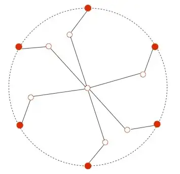

Actually, there are several relatively simple planar linkages whose configuration spaces are surfaces of higher genera. For instance, if $S_n$ is a linkage which is a "spider" with $n$ legs each of which has one joint and such that tips of the legs are glued to the plane, then the configuration space of $S_n$ is a surface of certain genus $g$. Such linkages (with $n=3$) first were analyzed (to the best of my knowledge) in a paper by Thurston and Weeks:
W. Thurston and J. Weeks, The Mathematics of three dimensional manifolds, Scientific American, 251 (1984) 94-106.
The following is a theorem proven in
P.Mounoud, Sur l’espace des configurations d’une araignee. Osaka J. Math., 48(1):149–178, 2011.
Theorem. Let $g$ be an natural number and $r$ the biggest integer such that $2r$ divides $g-1$. A compact orientable surface of genus $g$ is diffeomorphic to the configuration space of some spider if and only if $$ 2^{-r}(g − 1) \le 6r + 12.$$
On the other hand, if one allows linkages which are "centepides" then the oriented surface of any given genus is realized:
D. Jordan and M. Steiner Compact surfaces as configuration spaces of mechanical linkages, Israel Journal of Mathematics, 122 (2001) 175–187,
