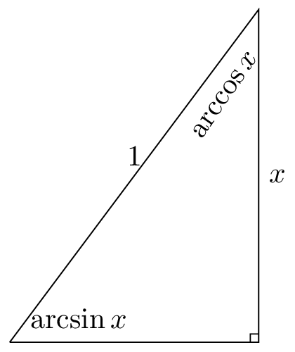

Here is a proof without words:
proof without words
