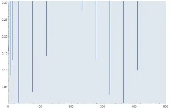

Plot of $- n(\sin n -1)$ for $1\leq n\leq 500$.
Dents in the blue background are small values. enter image description here Can someone point me in the right direction ?
