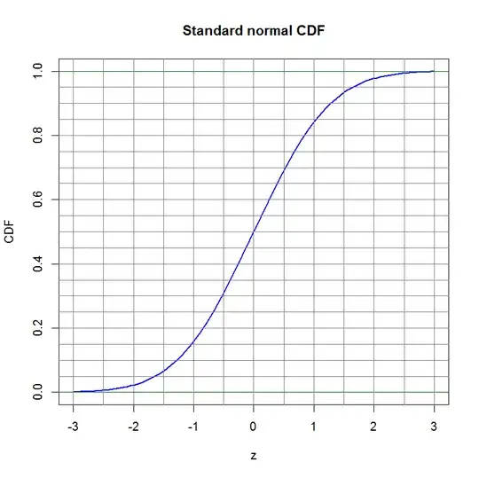

Here is a graph, from which you might be able to read some probabilities with 1 or 2-place accuracy.
