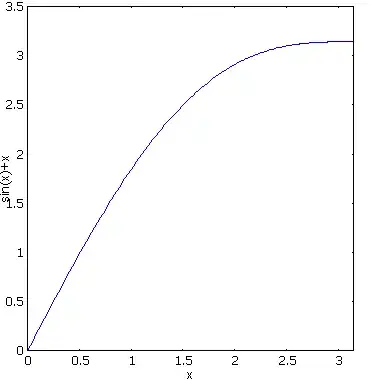

The function $x\to x+\sin x$ is continuous and increasing on $[0,\pi]$, hence it defines a bijection. Let $f(y)$ be the unique solution on $[0,\pi]$ of the equation $y=x+\sin x$, for $y\in[0,\pi]$.
Here is a plot of $x+\sin x$:
You may use series reversion around a point to find an approximation of the solution. Either it's enough, or you can use it to get the initial value of an iterative (Newton's method or Halley's method for instance).
