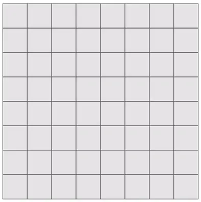

Let's first look at square tiling. Here's an image of an $8\times8$ unit squares:
What is the total length of all edges? It's easy to calculate. We have $9$ horizontal lines of length $8$ and $9$ vertical lines of length $8$. In general, for $n \times n$ unit squares we have $(n+1)n + (n+1)n = 2(n+1)n$ unit lengths.

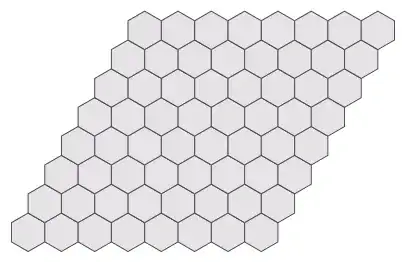

How does this compare to hexagon tiling? Look at the following image of $8\times8$ unit hexagons:
We again can notice $9$ "zigzag" horizontal lines and $9$ "zigzag" kind of vertical lines. What is the length of each of these lines? As you can see from the image, they span 8 hexagons, and 2 sides of each hexagon making the length of each line $8\times 2\sqrt\frac{2}{3\sqrt3}$. But there is overlap between the horizontal and vertical lines. Let's say we start with the vertical lines, then you can see that we have included half of the horizontal lines as well (except for a line at the boundary). So the total length of edges for a grid of $8\times8$ unit hexagons is $9 \cdot 8\cdot 2h + 9 \cdot 8h + 7h$, where $h=\sqrt\frac{2}{3\sqrt3}$ is the length of the side of the unit hexagon.
In general for a grid of $n\times n$ unit hexagons the total length is:
$$2h\cdot(n+1)n + h\cdot(n+1)n + h\cdot(n-1) = h\cdot(3(n+1)n + n-1) $$
The ratio of the sum of side lengths of the hexagonal tiling over the square tiling is: $$\frac{3h}{2}+ \frac{h(n-1)}{2(n+1)n}$$
So it does depend on $n$. The ratio is always less than $1$ (so hexagonal is always more efficient). It's smallest value is for $n=1$ and its largest value is for $n=2,3$. As $n \rightarrow \infty$ the ratio approaches the value of the ratio for a single cell ($n=1$).

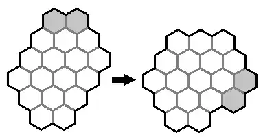

Now the question is: If the bees have to stop building at some point, what is the best shape? I.e. what shape has the shortest boundary relative to the number of cells?

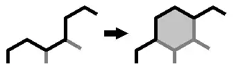

If there were big dents in the outer boundary, i.e. two consecutive 240 degree angles, then you could add a cell without changing the boundary length. So we can assume that there are no such dents.

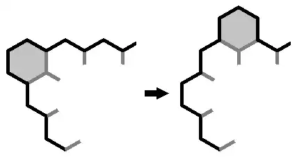

Similarly, you can also assume that there is no cell that has four boundary edges. If there were one, you could reattach it anywhere else without changing the boundary length, and in doing so create a dent. (I'm assuming there are enough cells so that there is some side of 3 or more cells to attach it to). Since we can rearrange and add cells without changing the total border length when there are cells with four sides on the border, we can assume there are no cells sticking out like that.
From this you will find that the only shapes left are essentially hexagonal. Not all hexagons are equally efficient however.
Suppose one side of the hexagon shape consisted of k cells, and a non-adjacent side had k+2 (or more) cells, then you could move one whole row of k cells from the first side and stick it onto the other side. This does not change the total boundary length. You have however created a dent that you can fill by adding a cell, so you can improve the efficiency.
Therefore the most efficient shapes are hexagons where the sides are almost of the same length (differ by at most 1 cell). These are local maxima, in that there is no way to rearrange and add cells without also increasing the boundary. Nevertheless, if you compare them, I think you'll find that the regular hexagon arrangement (i.e. all sides have exactly the same number of cells) will be the most efficient for its size.
  • Thank you, this is the kind of answer I was hoping for (starting to explore packing properties). Kudos for the illustrations! I do not understand this argument though: "you could reattach it anywhere else without changing the boundary length, and in doing so create a dent". As we start growing our comb, we are bound to have cells with 4 outer sides. – Thanassis Jul 26 '17 at 07:34
    Yes, as you add cells, you will get cells with 4 outer sides. The configuration you have at that point is not efficient though. You can then add more cells without changing the boundary length, making it more efficient. My argument is not really about finding the most efficient shape for a specific number of cells by minimising its boundary length (for some numbers of cells 4-outer-wall cells may be unavoidable). My argument is about finding the most efficient shape for a particular boundary length by maximising the number of cells. I show that the hexagon is the best point to stop building. – Jaap Scherphuis Jul 26 '17 at 09:21
