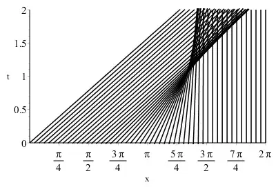

The initial data $u(x,0) = \phi(x)$ is continuously differentiable, with derivative $$ \phi'(x) = \left\lbrace \begin{align} &0 && \text{if}\quad x\leq \pi/2 \, ,\\ &\cos x && \text{if}\quad \pi/2\leq x \leq 3\pi/2 \, ,\\ &0 && \text{if}\quad 3\pi/2 \leq x \, . \end{align} \right. $$ In the case of Burgers' equation $u_t + u u_x = 0$, the time $t_B$ at which a shock occurs (or the minimal time where characteristic curves intersect) is given by (1) $$ t_B = \frac{-1}{\min \phi'(x)} = 1 \, . $$ This is illustrated in @JJacquelin answer, and in the following sketch of the $x$-$t$ plane:
characteristics
Note : cf. exercise 3.3. of
(1) R.J. LeVeque, Numerical Methods for Conservation Laws. Birkhäuser, 1992.

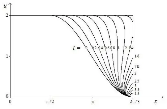

From this, it is possible to draw the curves $x(t)$ for various specified values of $u$.
Note that : $\quad 0\leq u\leq 2$
The figure below shows $u$ as a function of $x$ for various values of $t$ (Drawn from numerical calculus) :
$u=0$ for $t>\frac{2\pi}{3}$ and/or $x>\frac{2\pi}{3}$
