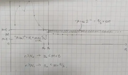

[I've been working through Goldberg myself and found this question looking for an explanation myself. I think I eventually figured it out.]

For the particular problem, by his alternate definition, for some $N_0$, $s_n < M + \epsilon$ if $n > N_0$ (and similarly, for some $N_1$, all $s_n < M + \frac{\epsilon}{2}$ if $n > N_1$).
Can we get $\sigma_n$ to eventually fit below $M + \epsilon$ too?
Proceeding as in the accepted answer and splitting the sum into two, the ultimately goal becomes finding a large enough $N_2$ such that $\sigma_n$ (which equals the sum of those two sums) is also smaller than $M + \epsilon$ (for arbitrary $\epsilon$ and all $n > N_2$).
An image may help motivate this: An image
The intuition is to "leave some room" between $M + \frac{\epsilon}{2}$ and $M + \epsilon$ such that the sum of the portions for the lower-indexed $s_i$ in $\sigma_n$ can be balanced out in some portion of the $\frac{\epsilon}{2}$-high strip extending from $N_1$ out to infinity.
(Here I'm thinking of the discrete sums as analogous to areas: can the area before $N_1$ fit into the area between $M+\frac{\epsilon}{2}$ and $M+\epsilon$? The answer seems pretty clearly yes to me based on the picture, but I still have to demonstrate the existence of some $N_2$ that works.)
The following reasoning seems to work (at least if $M \ge 0$, which can probably be made more rigorous for by translating each term of the sequence up by a well chosen constant and then undoing that later):
\begin{align} \sigma_n &= \frac{1}{n}\sum_{i=1}^{N_1}s_i + \frac{1}{n}\sum_{i=N_1+1}^n s_i \\\\ &\le \frac{N_1}{n}\max_{1\le i\le N_1}|s_i| + \frac{n-N_1}{n}(M + \frac{\epsilon}{2}) \\\\ &= M + \frac{\epsilon}{2} - \frac{N_1}{n}(M + \frac{\epsilon}{2}) + \frac{N_1}{n}\max_{1\le i\le N_1}|s_i| \end{align}
Doing some messy math we want to get the sum of the last two terms to be less than $\frac{\epsilon}{2}$ so that the whole $\sigma_n \le M + \epsilon$ (and therefore $\limsup_{n\to \infty} \sigma_n \le M$). Any $n \ge N_2 = \lceil\frac{2N_1}{\epsilon}(\max_{1\le i\le N_1}|s_i| - M - \frac{\epsilon}{2})\rceil$ seems to fit the bill.
