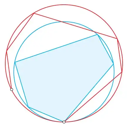

(2) Form a cyclic polygon from your lengths by shrinking the radius of a circle until your lengths close to a polygon:
See this MSE posting for cyclic polygon calculations, or the reference by @hardmath (in a comment) to another MSE posting on cyclic polygons.
