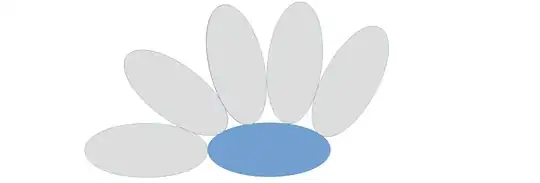

This is how (awkwardly) the packing is supposed to look:

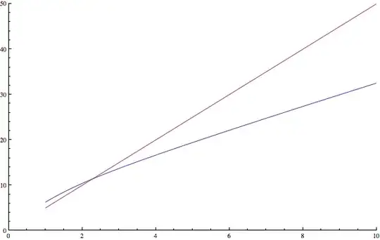

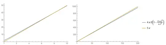

The approximation is very close to $5 a/b$, as we can see from the plot:
But how good is this approximation? And how to obtain a better estimate (or even exact value) for the maximum kissing number for arbitrary $a/b$ ratio?

This distance of course varies along the central ellipse, but we can compute its average value $\overline{d}$: $$ \overline{d}={1\over2\pi}\int_0^{2\pi}{2b\rho(t)\over a+\rho(t)}\,dt $$ where $t$ is the usual parameter and $$ \rho(t)={(a^2\sin^2t+b^2\cos^2t)^{3/2}\over ab}. $$ By dividing the length of the ellipse by $\overline{d}$ we thus get an estimate for the number $N$ of kissing ellipses: $$ N\approx{4 b E(1 - a^2/b^2)\over \overline{d}}. $$ Unfortunately I didn't succeed in finding a simple expression for $\overline{d}$, which must then be evaluated numerically. In the graph below I plotted the value of $N$ given above as a function of $a/b$ (blue). For comparison I also plotted your result $N\approx 5a/b$ (red).
I think this is a better approximation than yours, but don't know how good it is.

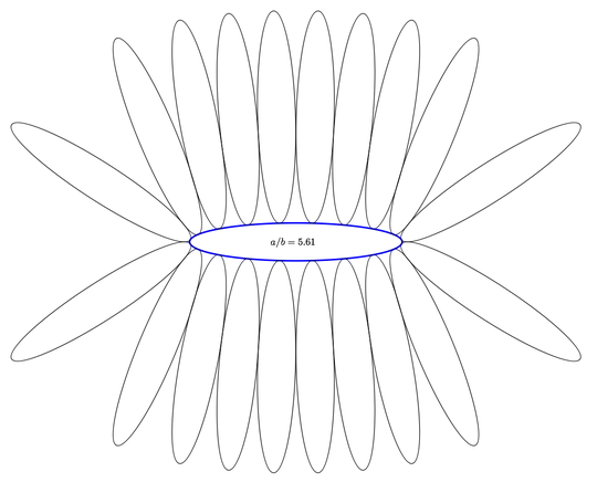

I made some experimentation with GeoGebra: for $a/b=2.87$ my formula gives $N\approx13.3$, while I managed to put at most $12$ tangent ellipses tightly packed:

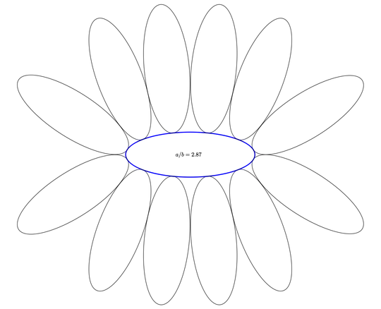

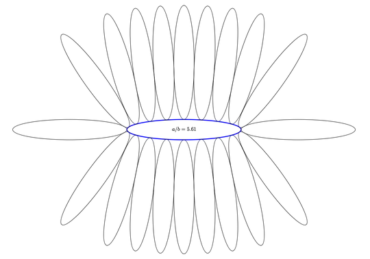

For $a/b=5.61$ my formula gives $N\approx21.8$, and $20$ tangent ellipses can be drawn (I'm showing two different arrangements):
It seems that the above formula for $N$, while still overestimating the actual number of ellipses, is quite good for large values of $a/b$.

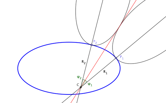

Consider a point $C$ on the extension of the major axis of an ellipse, at a distance $R$ from its nearest vertex. A straightforward calculation shows that the angle $\varphi$ between the major axis and a tangent to the ellipse passing through $C$ is given by $$ \varphi =\arctan{b\over\sqrt{R(R+2a)}}. $$ Consider now two consecutive "kissing" ellipses (see diagram below), touching the inner ellipse at their vertices $P_1$ and $P_2$ and tangent between them at $T$. Let $C$ be the intersection of their (produced) major axes: line $CT$ is (to a very good approximation) a common tangent to both ellipses, forming angles $\varphi_1$ and $\varphi_2$ with their major axes, which can be computed with the above formula.
Distances $R_1$ and $R_2$ can be computed from the coordinates of $P_1$ and $P_2$, as well as the angle $$ \angle P_1CP_2=\arccos{R_1^2+R_2^2-\overline{P_1P_2}^2\over2R_1R_2}. $$ But this angle is the sum of $\varphi_1$ and $\varphi_2$, so we have the equality: $$ \arccos{R_1^2+R_2^2-\overline{P_1P_2}^2\over2R_1R_2}= \arctan{b\over\sqrt{R_1(R_1+2a)}}+\arctan{b\over\sqrt{R_2(R_2+2a)}}. $$ From this equation one can, in principle, find $P_2$ once $P_1$ is given. This can be done numerically and can be used to build a routine which actually finds all kissing ellipses: starting with $P_1$ (which I took at one vertex of the inner ellipse) one can find $P_2$, then $P_3$ and so on, stopping with the last ellipse not intersecting the first one.

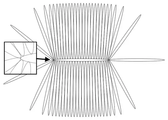

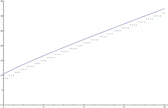

I wrote some Mathematica code which performs this task, thus computing the number of kissing ellipses. As an example, you can see below the case $a/c=20$, with $55$ tangent ellipses. The detail in the square is a magnification of the left vertex zone.
The plot below shows the number of kissing ellipses (black dots) as a function of $a/c$. The blue line is the approximate value found above.

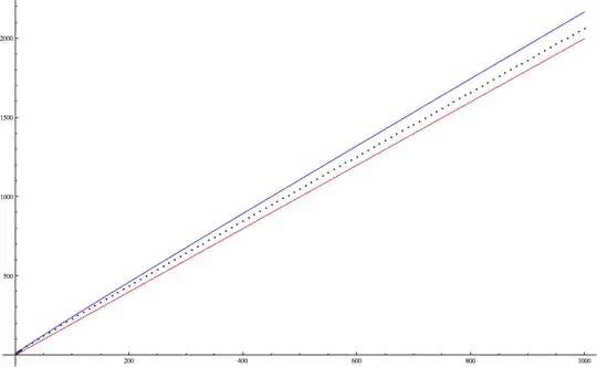

For large values of $a/b$ I expect $N\approx 2a/b$, because a very thin ellipse should behave approximately like a $2a\times2b$ rectangle as $a/b\to\infty$, plus some tiny "border effect". This is confirmed by the numbers I got from Mathematica, which are plotted below:
I added for comparison the plot of my estimate (blue) and of $2a/b$ (red). As you can see, for very large values of $a/b$ the very simple rule $N\approx 2a/b$ is a better approximation. This trend is confirmed for even larger values: $N(1000)=2064$, $N(2000)=4081$, $N(3000)=6094$, $N(4000)=8105$, $N(5000)=10128$.
