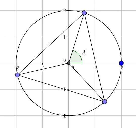

Consider the following picture. We see that the triangle with vertices $(\cos A, \sin A), (\cos(A+120^\circ), \sin(A+120^\circ)), (\cos(A+240^\circ), \sin(A+240^\circ))$ are the vertices of an equilateral triangle with centriod at the origin. enter image description here
Thus if we set $a = \cos A, b = \cos(A+120^\circ), c = \cos(A+240^\circ)$, then \begin{align*} a+b+c = 0 \end{align*} and hence \begin{align*} a^3+b^3+c^3 = 3abc \end{align*} and \begin{align*} \cos^3{A} + \cos^3{(120°+A)} + \cos^3{(240°+A)} &= 3\cos A \cos(A+120^\circ)\cos(A+240^\circ) \\ &= \frac{3}{2}(2\cos A \cos(A+120^\circ))\cos(A+240^\circ) \\ &= \frac{3}{2}[\cos(2A+120^\circ)+\cos(120^\circ)]\cos(A+240^\circ)\\ &=\frac{3}{2}\cos(2A+120^\circ)\cos(A+240^\circ)-\frac{3}{4}\cos(A+240^\circ)\\ &=\frac{3}{4}\cos(3A+360^\circ)+\frac{3}{4}\cos(A-120^\circ) -\frac{3}{4}\cos(A+240^\circ)\\ &=\frac{3}{4}\cos(3A) \end{align*} since $\cos(A+240^\circ) = \cos(360^\circ - (A+240^\circ)) = \cos(120^\circ -A) = \cos(A-120^\circ)$
  • If you can see geometrically, the points $(\cos A, \sin A), (\cos(120^\circ+A), \sin(120^\circ+A)), (\cos(240^\circ), \sin(240^\circ+A))$ are the vertices of an equilateral triangle with centroid as the origin, then the above proof holds since we have used only an algebraic identity. –  Sep 10 '16 at 07:23
