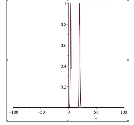

In maple I'm trying to graph 3 normal distributions, each one being a shift of the other.
I run the following code in maple and then get the following plot
plots[multiple](plot, [exp(-(x-4)^2), x = -5 .. 5], [exp(-(x-12)^2), x = -5 .. 5], [exp(-(x-20)^2), x = -100 .. 100]);
Which is an issue. I don't see what I did wrong. Can someone shed light on this?

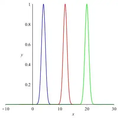

I think you should change the intervals:
[> with(plots):
   a := plot(exp(-(x-4)^2), x = -5 .. 15, color = blue):
   b := plot(exp(-(x-12)^2), x = -5 .. 15, color = red):
   c := plot(exp(-(x-20)^2), x = -10 .. 30, color = green):
   display(a, b, c);
