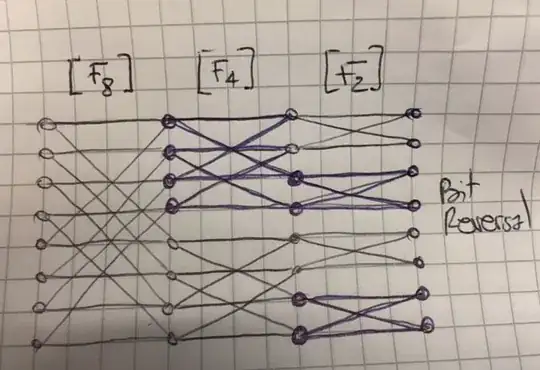

The last thing to clarify is the butterfly idea (see also [2]). For this, nothing better than a small drawing (sorry I didn't want to do this in Tikz, if there's a hero out there...). If you represent the vectors after each stage by dots and you connect the dots from the original vector to the vector after the matrix has been applied, you get this nice diagram (ignoring the bit reversal)
Butterfly diagram
I've tried to make clear on the diagram that the first level corresponds to 4 applications of $F_2$, the next level to 2 applications of $F_4$ etc. Just to make it clearer, starting from the right it means that the first matrix multiplication after the bit-reversal will
  • for the first entry, need to look at the first and the second entry of the original vector (corresponding to a non-zero entries at positions (1,1) and (1,2) in that level's matrix)
  • for the next entry, need to look at the first and the second entry (this makes the first block in the "F2" column (corresponding to non-zero entries at positions (2,1) and (2,2))
etc.. Further, observe that, at each level, we can consider blocks of entries independently. Again this leads to further optimization that can make the FFT very very efficient.

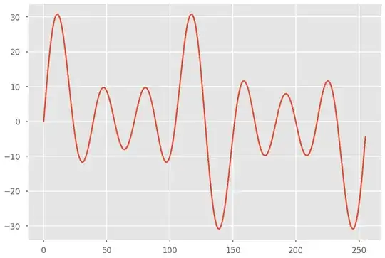

With the following signal in the time domain as shown below and applying the FFT on the input signal $x$ we obtain the frequency domain output signal $X$:
import numpy as np
import matplotlib.pylab as plt
sampling rate
sr = 256
sampling interval
ts = 1.0/sr t = np.arange(0,1,ts)
time domain signal
x = np.zeros_like(t) for f in range(1,9,2): x += (2f+1)np.sin(2np.pif*t) plt.plot(x) plt.show()

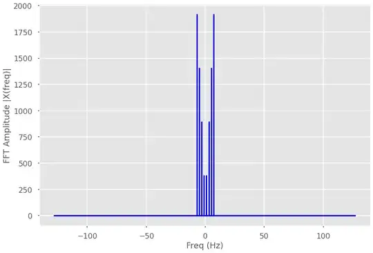

We can obtain the centered frequency spectrum with FFT as follows:
X = FFT(x)
plot frequency domain signal by centering (fftshift)
N = len(X) n = np.arange(N) T = N/sr freq = n/T
plt.stem(freq-N//2, np.roll(abs(X),N//2), 'b',
markerfmt=" ", basefmt="-b") plt.xlabel('Freq (Hz)') plt.ylabel('FFT Amplitude |X(freq)|')
As expected, since we used $4$ frequency values, namely $1,3,5,7$ to construct the input signal in the time domain, the frequency domain output also contains the same frequencies with the corresponding proportional amplitudes.

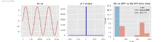

The following animation compares the distribution of time taken by naive DFT vs. the above divide-conquer FFT algorithms when the input signals are of length $2^{10}$ or $2^{11}$:
