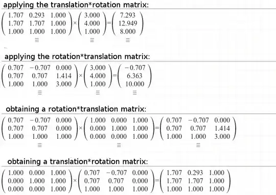

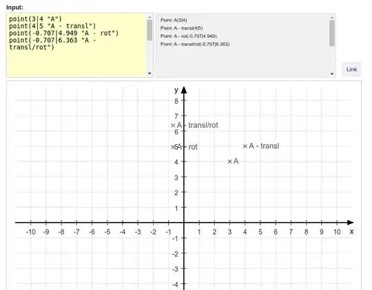

This works for only translation (T) and for rotation*translation (R * T). But produces garbage for T * R. As you can see in my graph and calculations, I would expect A' = TRA somewhere around [0.3,6] point but it is not.
What am I missing? I'd appreciate pointing me in the right way.
image 1
(^In afterthought: I labelled operations in the order of reading, so "A - transl/rot" is technically actually: R * T * A )
image 2

If you want to rotate and translate a 2D point $p=[x,y]^T$, then this can be written $$ q = Rp + t $$ where $t=[t_x,t_y]^T$ and $R\in SO(2)$ as a $2\times 2$ matrix.
To put this as a matrix multiplication, notice that $$ \underbrace{ \begin{bmatrix} q \\ 1 \end{bmatrix}}_{q_h} = \underbrace{ \begin{bmatrix} R & t \\ 0 & 1 \end{bmatrix}}_{M} \underbrace{ \begin{bmatrix} p \\ 1 \end{bmatrix}}_{p_h} $$ simply as a fact of linear algebra. This can be interpreted as moving $p$ to homogeneous coordinates $p_h$, and then constructing $M$ by appending $t$ to it (after moving $t$ to homogeneous coordinates). From a geometric perspective, why must we place zeros underneath $R$ (which is the solution you discovered)? It is because we need the last element of $q_h$ (say $a$) to be $1$, else we would be moving (scaling) $q$ by $a$ in real space!

There are deeper points here that are worth noting:
  • Translation is not a linear transformation. Hence it cannot be written as a multiplication by a matrix (unless one uses clever tricks).
  • Rotating and then translating will give different results to translating and then rotating.
Proof that translation is not linear: Define $T(x)$ as the transformation that translates the point $x$ by a displacement $b$. Then $T(x) = x + b$ for any point $x$. Now suppose that $T$ is a linear transformation. Then by definition we must have $T(x+y) = T(x) + T(y)$ for all $x$ and $y$. Now $T(x+y) = x+y + b$ but $T(x) + T(y) = x+b + y+b = x+y + 2b$ so we have equality for all $x$ and $y$ if and only if $b=0$.
