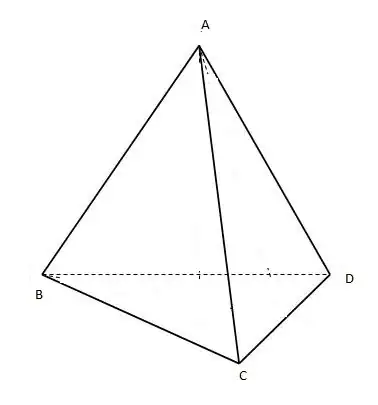

If $ABCD$ is a regular tetrahedron with $AB=l, $what is the measure of the angle between $AB$ and $ACD$ or mathematically $\angle(AB, (ACD))$ and I ask you, please, to explain the method. Thanks.
Iuli
  • 6,870
  • Construct the lines $AE$ and $BE$ where $E$ is the midpoint of $CD$. $ABE$ is a triangle (isosceles) and the angle at $A$ is the one you want to find. $AE$ and $BE$ are perpendicular to $CD$ so you have plenty of information to find the angle you want. – Mark Bennet Sep 02 '12 at 20:06

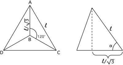

Position the three points $ADC$ at the vertices of an equilateral triangle in the $xy$-plane, say $A(1,0,0)$, $D(-1/2,\sqrt{3}/2, 0)$ and $C(-1/2,-\sqrt{3}/2,0)$; then the side lengths are $\sqrt{3}$; $B$ is on the $z$-axis at an equal distance from A(1,0,0), so it is $B(0,0,\alpha)$ where $1+\alpha^2=3$.
Thus we have a right triangle $BOA$ with one leg of length 1, other of length $\sqrt{2}$ so the hypotenuse is $\sqrt{3}$ and then the angle $\theta$ at $A$ has $\cos(\theta)=1/\sqrt{3}$, $\sin(\theta)=\sqrt{2/3}$.
The orthogonal projection of the three edges $\overline{AB},\overline{CB},\overline{DB}$ onto $\triangle ACD$ have length $\mathcal{l}/\sqrt3$.
$\hspace{3.3cm}$enter image description here
This gives $\cos(\alpha)=\frac1{\sqrt3}$
robjohn
