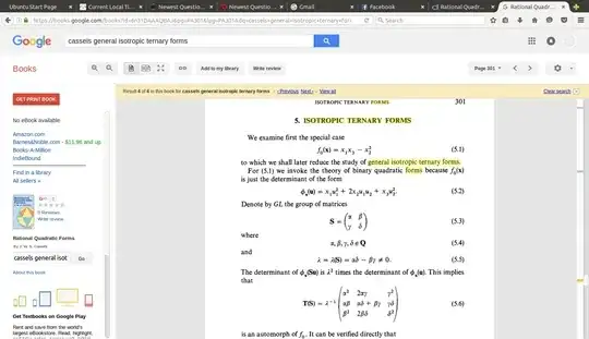

If we simply multiply out the entries we get $$ \left( \begin{array}{c} x_{n+1}^2 \\ x_{n+1} y_{n+1} \\ y_{n+1}^2 \end{array} \right) = \left( \begin{array}{rrr} 4 & 12 & 9 \\ 2 & 7 & 6 \\ 1 & 4 & 4 \end{array} \right) \left( \begin{array}{c} x_{n}^2 \\ x_{n} y_{n} \\ y_{n}^2 \end{array} \right) $$ This 3 by 3 matrix is sort of famous, as we have taken a 2 by 2 matrix in the modular group and produced a 3 by 3 image in $SL_3 \mathbb Z;$ the map is an isomorphism. You can find this construction on page 58 of Zagier or page 23 of Magnus. Actually, Magnus and Zagier use transposes of each other's matrices, can't have everything. With the letters permuted, page 301 of Cassels.

Here is page 301 in Cassels. He switches $\beta, \gamma$ in the 3 by 3 matrix, compared with what I typed above.
