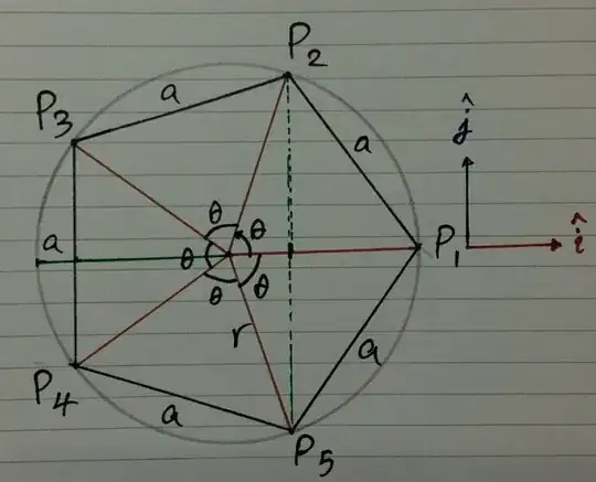

In such arrangement of identical charged particles named $P_1$, $P_2$, ..., $P_n$ (In this diagram $n=5$), the electric field in the center is always zero.
arrangement
The electric field is given by this equation:
$$\vec F=k\frac{q}{r^2}\hat r$$
Where $\hat r$ points to the radial direction.
If $2|n$, then the forces are obvious canceled by symetry.
If $n$ is odd, again the components of forces in the $y$ axis cancel by symetry. But for the $x$ direction the components cancel if this condition is true:
$$\sum_{c=0}^{n-1}\cos(c \theta)=0 \ \ \ \ \ \ \theta=\frac{2\pi}n$$
[END OF INTRO]
My main problem is to prove for any $n$, this relation holds:
$$\sum_{c=0}^{n-1}\cos(2\pi \frac{c}{n})=0$$

  • Intuitively, if all of those radii are vectors, they cancel out and equal the zero vector. That means that, not only do the vertical components cancel (which is easy to see independently, because $\sin(-x)=-\sin(x)$), but so do the horizontal components. – G Tony Jacobs Aug 21 '16 at 16:53
    @GTonyJacobs Of course! But one will have to merge that intuition with a proof if he wants to make sure that the intuition is right. – AHB Aug 21 '16 at 16:56
  • I wasn't arguing against proof-writing, @AHB. Another perspective is that of symmetry: If there is a net pull in any direction, then by rotating our coordinates repeatedly through an angle of $\theta$, that net pull should be in each of 5 different directions! – G Tony Jacobs Aug 21 '16 at 16:58

    The force $F_1$ at the orgin exerted by $P_1$ is horizontal and makes an angle of $\pi$ with respect to the positive axis. Add to that the force $F_2$ exerted by $P_2,$ which has the same magnitude but makes an angle of $\pi+2\pi/5$ with respect to the positive axis. Keep going. Adding $F_1 + \cdots +F_5$ as vectors of course means starting with $F_1$ pointing from at $0,$ starting $F_2$ at the end of $F_1,$ etc. What you'll see is that the vector sum leads you around the perimeter of a regular pentagon. We started at $0,$ and we have to end at $0!$ – zhw. Aug 21 '16 at 17:46
  • Do you agree that the total force at the center should be independent of the orientation of this arrangement of charges? If so, then it must be the case that the $x$-components cancel since you can swap the roles of the $x$- and $y$- axes without changing the total charge. – amd Aug 21 '16 at 23:12
  • @amd That is an easily understood non-mathematical proof. Proof by contradiction. Thanks. – AHB Aug 22 '16 at 08:47
