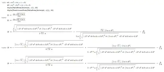

Then I thought about searching it on the solutions for cubic equations with some help of Mathematica, but I got nothing that was similar to:
$$(bc-ad)^2-4(ac-b^2)(bd-c^2)=0$$
or:
$$a^2d^2-6abcd+4b^3d+4ac^3-3b^2c^2=0$$
With no success. You can see it here:
