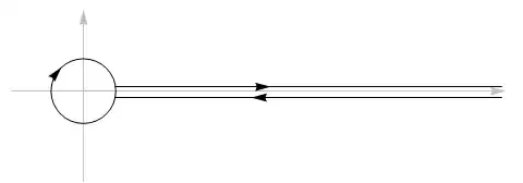

Step 2. Next, we give an explicit formula for $I(\eta, s)$ for small $\eta > 0$. (By small, we mean $\eta \in (0, 2\pi)$.) This is easily done by mimicking the derivation of the functional equation for $\zeta$ by contour integration. To this end, we first restrict ourselves to the case $\Re(s) \in (1, 2)$ and consider the contour
$\hspace{5em}$contour
Call by $C_{\eta}$ the entire contour and by $\Gamma_{\eta}$ the circular arc. Assuming the branch cut of $\log$ as $[0, \infty)$, this can be computed as
\begin{align*} &I - \mathrm{e}^{-2\pi i s} I + \int_{\Gamma_{\eta}} \frac{z^{-s}}{\mathrm{e}^z - 1} \, \mathrm{d}z \\ &\hspace{3em} = \int_{C_{\eta}} \frac{z^{-s}}{\mathrm{e}^z - 1} \, \mathrm{d}z = 2\pi i \sum_{n \in \Bbb{Z}\setminus\{0\}} \underset{z=2\pi i n}{\mathrm{Res}} \; \frac{z^{-s}}{\mathrm{e}^z - 1} \\ &\hspace{6em} = 2i \mathrm{e}^{-i\pi s} (2\pi)^{1-s} \cos\left(\frac{\pi s}{2}\right) \zeta(s). \end{align*}
This gives
$$ I(\eta, s) = \frac{1}{1 - \mathrm{e}^{-2\pi i s}} \int_{-\Gamma_{\eta}} \frac{z^{-s}}{\mathrm{e}^z - 1} \, \mathrm{d}z + \frac{(2\pi)^{1-s}}{2\sin\left(\frac{\pi s}{2}\right)} \zeta(s) $$
Since both sides define entire functions on all of $\Bbb{C}$, this identity extends to all of $s \in \Bbb{C}$. Now we plug the power series $\frac{z}{\mathrm{e}^z - 1} = \sum_{n=0}^{\infty} \frac{B_n}{n!} z^n$ into the contour integral above to get
\begin{align*} I(\eta, s) &= \sum_{n=0}^{\infty} \frac{B_n}{n!} \frac{\eta^{n-s}}{s - n} + \frac{(2\pi)^{1-s}}{2\sin\left(\frac{\pi s}{2}\right)} \zeta(s) \tag{2} \\ &= \sum_{n=0}^{\infty} \frac{B_n}{n!} \frac{\eta^{n-s}}{s - n} + \Gamma(1-s)\zeta(1-s) \tag{3} \end{align*}
