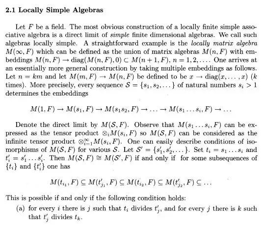

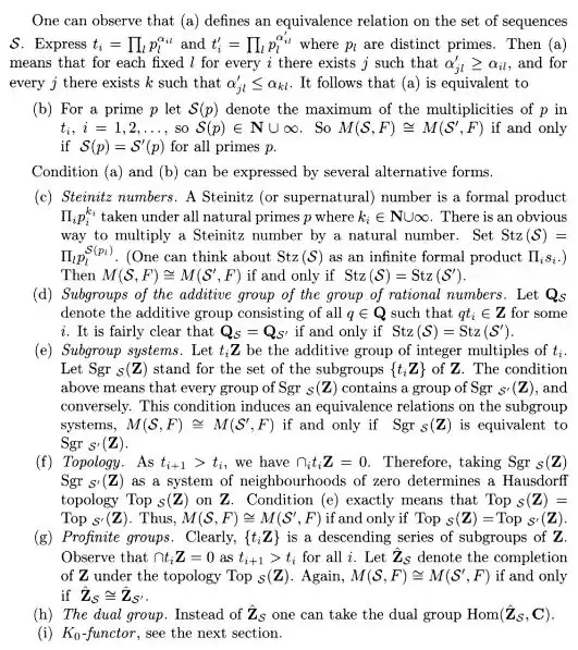

To better comprehend supernatural (or Steinitz) numbers it is illuminating to examine the various contexts in which they arise naturally. For example, see the equivalent conditions $(c)-(i)$ listed below (excerpted from here).
Note $ $ Said descriptions are independent of the first three introductory paragraphs on locally simple algebras, so you can skip them if such algebras are not of interest (start reading at the paragraph "One can observe that ...")
Bill Dubuque
  • 282,220
  • Wow that is some pretty heavy reading! – Robert Frost Aug 15 '16 at 15:06
  • @RobertFrost I suggest you start first with relation to subgoups of the additive group or rationals (d), which is perhaps the simplest. – Bill Dubuque Aug 15 '16 at 15:11
