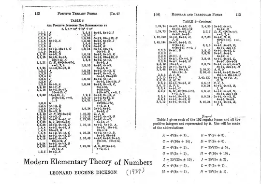

Wednesday: Make an answer; this is my area. Your question follows from the fact that, given integer $n \geq 0,$ we can always write $$ 6n+1 = u^2 + 6 v^2 + 12 w^2 $$ in integers.
The ternary form $ u^2 + 6 v^2 + 12 w^2 $ is not regular. Up to a million, there are some ten numbers that are not represented by the form, but instead are represented by the other form in the genus, that being $3 u^2 + 4 v^2 + 6 w^2.$ These sporadic numbers are, however, all multiples of three.
  3         39         51         69        165        219
399        561        771       1941
Taken together, the forms of the genus represent all positive integers except $3k+2$ and $4^k (16m+14).$ Compare the form $1,3,6$ in Dickson's table:
The composition of the genus is shown in this excerpt
