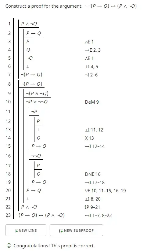

-1
The OP is looking for the following:
Given the definition of implication, I understand why this is true, but I need a bit of help showing this with a formal proof using rules like ∨−Elim and ⊥−Intro.
The following proof uses disjunction elimination ("∨−Elim" or "vE") on line 20 and negation introduction ("⊥−Intro" or "⊥I") on lines 6 and 21.
For a description of the justification used see the text forallx and the associated proof checker referenced below.
Kevin Klement's JavaScript/PHP Fitch-style natural deduction proof editor and checker http://proofs.openlogicproject.org/
P. D. Magnus, Tim Button with additions by J. Robert Loftis remixed and revised by Aaron Thomas-Bolduc, Richard Zach, forallx Calgary Remix: An Introduction to Formal Logic, Winter 2018. http://forallx.openlogicproject.org/
