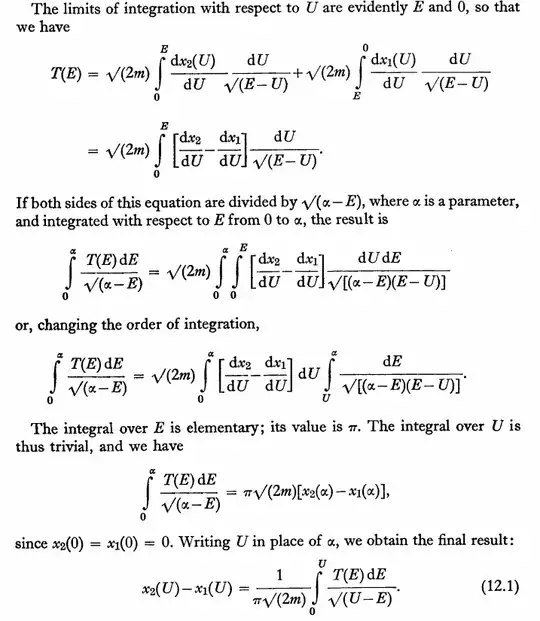

I would like to know more about the following integration technique encountered in Landau and Lifshitz' Mechanics, wherein the authors solve an integral equation for $x_2 - x_1$ as a function of $U$ by multiplying the equation by a factor with an unspecified parameter $\alpha$ and integrating over $\alpha$:
Integration Technique
Specifically, I would like to know
  1. What is this technique called?
  2. When can I expect to use it?
  3. Other integrals for which it is useful.

First of all, I think there is no name for this as a technique.
This technique is, IMHO, not to be remembered, because the same result can be achieved with Laplace Transform through a more direct path.
The basic observation is that convolution operation is hidden everywhere. The function (or, better said, distribution) with which one "convolves" is :
$$K(E):=\dfrac{1}{\sqrt{E}}.$$
You find a convolution by this function $K$ as well :
  • in the initial equation which can be expressed as: $ \ T=\sqrt{2m}((x'_2-x'_1) * K) \ \ (1)$ and
  • in the final equation: $ \ x_2-x_1=\dfrac{1}{\pi \sqrt{2m}}T * K \ \ (2)$.
Remark : These convolutions are in the sense of "causal" functions (all concerned functions are zero for negative values of the variable): see edit at the bottom.
This induces the fact that this computation can entirely be done using Laplace Transform (and convolution !) taking into account the fact that L.T. of $\dfrac{1}{\sqrt{t}}$ is $\sqrt{\pi}\dfrac{1}{\sqrt{s}}$ (see for example this).
Here is the detail of the computation:
Let us convolve equ. (1) by $K$ .
$$T * K = \sqrt{2m}(x_2 - x_1)' * K * K.$$
Now we take the L.T. of the RHS (only): $\sqrt{2m} s(X_2-X_1).\dfrac{\pi}{s}$
The two $s$ cancel ; taking now the inverse L.T., one gets $\sqrt{2m} (x_2-x_1).\pi$, which, equated with $T * K$, gives an equation equivalent to (2), as desired.
More economical than the method of Landau and Lifshitz (very witty, for sure), isn't it ?
Remarks : 1) Convolution by $K$ is equivalent to the operation of mult. by $\dfrac{1}{\sqrt{\alpha - E}}$ in L. & L. computation.
2) Have you noticed where $\pi$ has crept into the computations ?
Final remark: I have been looking for a specific integral transform (like Mellin transform) that could also explain things, but I have found nothing till now.
