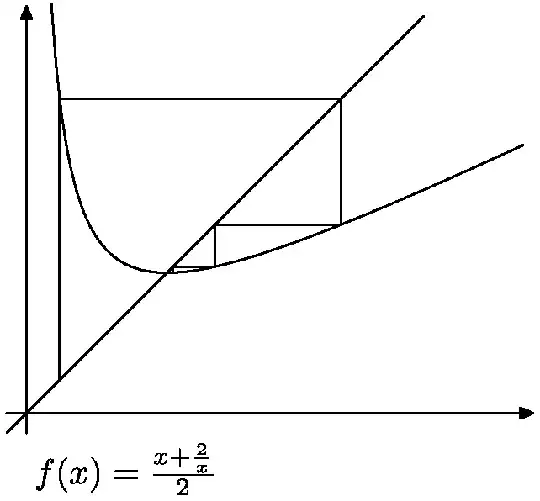

Illustration of Babylonian method for $f(x)=\frac12(x+\frac2x)$.
Iterations of f(x)=(x+2/x)/2

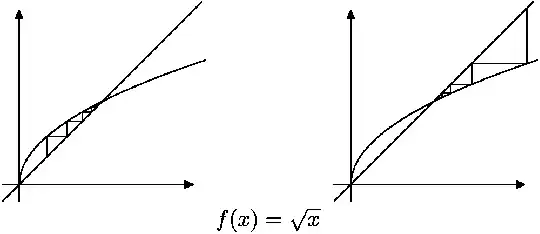

Iterations of $f(x)=\sqrt x$
Iteratrions of sqrt(x)

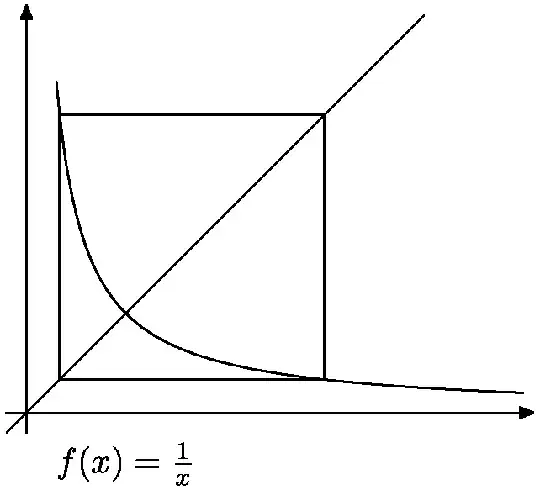

Iterations of $f(x)=\frac1x$
Iterations of f(x)=1/x

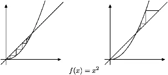

Iterations of $f(x)=x^2$
Iterations of f(x)=x^2
