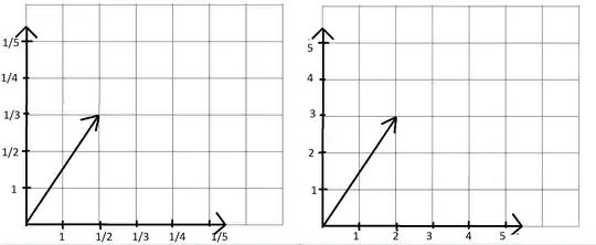

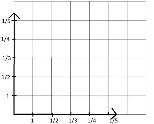

In our new idea of distance, we will work with reciprocal space (I am aware that term is used to describe a crystal lattice, but I am not using the same thing here). BOTH the x and y axes (we'll start working in 2 dimensions) will be re-scaled such that x=1/x and y=1/y. The origin will be replaced with a single "point at infinity" similar to projective geometry.
"Reciprocal Axes"
Graphing reciprocal vectors in a space which is measured this way satisfies requirement #1 - preserving direction. So all three requirements are satisfied with this new definition, provided we say that this isn't a vector, and it lives in a different space.
The vector $\langle 2,3 \rangle$ (shown right) when graphed in Cartesian space looks the same as the vector $\langle \frac{1}{2},\frac{1}{3} \rangle$ (shown left) graphed in reciprocal space.
"Vectors in Cartesian space look identical to invectors in reciprocal space"
