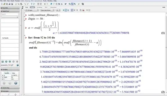

We denote the $n$th term of Fibonacci number with $F_n$. Assume that $\alpha=\frac{1+\sqrt{5}}{2}$. With simulation, I found the following relation between Fibonacci number and the golden section $$ \mid \frac{F_{n+1}}{F_{n}}-\alpha\mid \, \approx \, \frac{1}{(F_n)^2}~. $$ Is there a analytical method that we can proof the mentioned formula. I would greatly appreciate for any suggestions.
Maple simulation

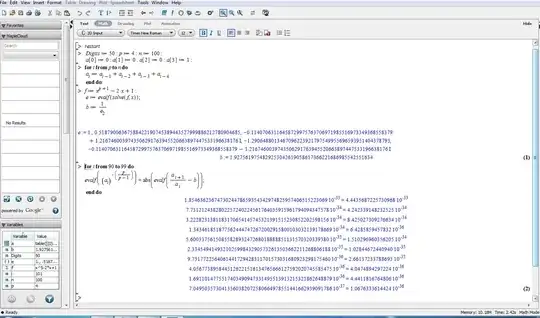

One of the most important generalization of the classical Fibonacci numbers is the Fibonacci $p$-step numbers that is defined as follows $$ \begin{equation}\label{cp26} F_n^{(p)}=F_{n-1}^{(p)}+F_{n-2}^{(p)}+\cdots+F_{n-p}^{(p)}\, . \end{equation} $$ With boundary conditions $$ F_{0}^{(p)}=0\quad , \quad F_{1}^{(p)}=0\quad ,\, \cdots\, ,\quad F_{p-2}^{(p)}=0\quad , \quad F_{p-1}^{(p)}=1\, . $$
We can get the limit value of Fibonacci $p$-step numbers by inverse of solution of equation $x^{p+1}-2\, x+1=0$ in the interval $(0,1)$. We denote the limit value of Fibonacci $p$-step numbers with $\alpha_p$. In fact, $\alpha_p$ is defined in the following form $$ \alpha_p=\displaystyle{\lim_{n\rightarrow\infty}}\quad \frac{F^{(p)}_{n+1}}{F^{(p)}_{n}}~. $$ The generalization of the above formula is $$ \mid \frac{F^{(p)}_{n+1}}{F^{(p)}_{n}}-\alpha_p\mid \, \approx \, {F^{(p)}_{n}}^{-{\displaystyle{(\frac{p}{p-1})}}}~. $$

    @Amin23 It'd be better to have the generalization as a separate post - its answer isn't particularly related to the answer to your original question. Unless I'm terribly mistaken, your conjecture is true for $p=3$ and false for $p=4$. (It seems to be more of a coincidence than anything else, but I'm not certain) – Milo Brandt Jul 23 '16 at 23:02
  • @MiloBrandt This conjecture is true for all case of $p$. Please see image file for the case $p=4$. In fact, this conjecture is an especial case of the following question http://math.stackexchange.com/questions/1837391/the-connection-between-the-length-of-fibonacci-p-step-numbers-and-its-limit-v – Amin235 Jul 24 '16 at 05:15

The most direct way to deal with the Fibonacci numbers is to use Binet's formula: $$F_n=\frac{\varphi^n - (-\varphi)^{-n}}{\sqrt{5}}$$ where $\varphi=\frac{1+\sqrt{5}}2$. So, the ratio of $\frac{F_{n+1}}{F_n}$ can be written in closed form as: $$\frac{F_{n+1}}{F_n}=\frac{\varphi^{n+1} - (-\varphi)^{-n-1}}{\varphi^n - (-\varphi)^{-n}}$$ Note that this obviously tends towards $\varphi$ as $n$ goes to $\infty$, since the $(-\varphi)^{-n}$ terms quickly go to zero. Now, you additionally want to show that the difference between this ratio and $\varphi$ shrinks with $\frac{1}{F_n^2}$. To do this, let us take that difference symbolically: $$\frac{F_{n+1}}{F_n}-\varphi = \frac{\varphi^{n+1}-(-\varphi)^{-n-1}}{\varphi^n-(-\varphi)^{-n}}-\frac{\varphi^{n+1}+(-\varphi)^{-n+1}}{\varphi^n-(-\varphi)^{-n}}=\frac{-(-\varphi)^{-n+1}-(-\varphi)^{-n-1}}{\varphi^n-(-\varphi)^{-n}}$$ Then, we use that $(\varphi)^{-1}+\varphi=\sqrt{5}$ to simplify to $$\frac{F_{n+1}}{F_n}-\varphi = \frac{\sqrt{5}(-\varphi)^{-n}}{\varphi^n - (-\varphi)^{-n}}\approx \frac{\sqrt{5}(-1)^n}{\varphi^{2n}}\approx \frac{(-1)^n}{\sqrt{5}F_n^2}$$ where the $\approx$ signs indicate that the ratio of the two sides of the "equation" tends to $1$ as $n$ goes to $\infty$. We use that $F_n\approx \frac{\varphi^n}{\sqrt{5}}$, which implies $F_n^2\approx \frac{\varphi^{2n}}{5}$

    Actually, you must have made a mistake because the last exact equality doesn't hold. Also, assuming you're dealing with asymptotic equivalence (since trivially the expressions in the OP are both $\approx0$), one actually has $$\frac{F_{n+1}}{F_n}-\varphi\sim\frac{(-1)^n}{\sqrt{5} F_n^2}.$$ – Vincenzo Oliva Jul 24 '16 at 09:00
    @VincenzoOliva Thank you - I found the error and fixed it. – Milo Brandt Jul 24 '16 at 14:27
