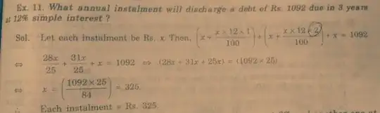

I am adding the solution from one book for the given question but I don't understand it. So can anyone explain it? Or can anyone give there own solution to the given question?
Solution given in the book is

Your repayment amount yields an interest of 12% per year. The last installment (the third)does not fetch any interest. The second installment will give 12% interest for one year. That is, the amount $x$ paid at the end of second year would be $x + \frac{x \times 12}{100}$ at the end of third year. The installment you paid at the end of first year will fetch interest for 2 years. Thus it would be $x + \frac{2 \times x \times 12}{100}$. Thus we must have \begin{align*} x \text{ (last installment) } + \left(x + \frac{x \times 12}{100}\right) \text{ (second installment) } + x + \frac{2 \times x \times 12}{100} \text{ (first installment) } = 1092 \end{align*} The rest is clear to you, I suppose.
  • but I don't understand if it is the problem of simple interest, the installment for each year should be same . but here in the solution, every year installment is different. Why is it so? – sagar Jul 19 '16 at 12:44
  • Instalment is the same, $x$. It earns interest every year. It is like putting $X$ $ every year for three years and withdrawing the money at the end of third year and paying the debt. –  Jul 20 '16 at 00:51

  • yes,they have asked for the each instalment. And they have given answer : each installment= 325. But I don't know how they got the given answer. Also, What is "amount of principal" here? And what is 1092 in the given question? – sagar Jul 18 '16 at 10:02
    The total amount comes to only 975, How can it clear a debt of 1092$? –  Jul 18 '16 at 10:05
  • Perhaps this question and answer can help you. http://math.stackexchange.com/questions/838691/what-annual-installment-will-discharge-a-certain-debt – Zach Zundel Jul 18 '16 at 10:07
  • @Muralidharan I have added the image in which the solution for the question is given. But I don't understand it. If you understand it, will you please explain me. – sagar Jul 18 '16 at 10:18
