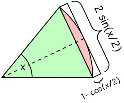

A Geometric Proof
The posed inequality is equivalent to $\sin(x)\ge x-x^3/4.$
Consider the wedge of the unit circle below:
$\hspace{32mm}$enter image description here
The area of the whole wedge (red and green regions) is $\frac12x$, and the area of the green triangle is $\frac12\sin(x)$. Thus, we get that $\sin(x)\le x$. Furthermore, the area of the red region is $\frac12(x-\sin(x))$.
Noting that the red region is contained in the rectangle with base $2\sin(x/2)$ and height $1-\cos(x/2)$, we get that $$ \begin{align} \tfrac12(x-\sin(x)) &\le2\sin(x/2)(1-\cos(x/2))\\ &=4\sin(x/2)\sin^2(x/4)\\ &\le x^3/8 \end{align} $$ which yields $$ x-x^3/4\le\sin(x) $$ as desired.
