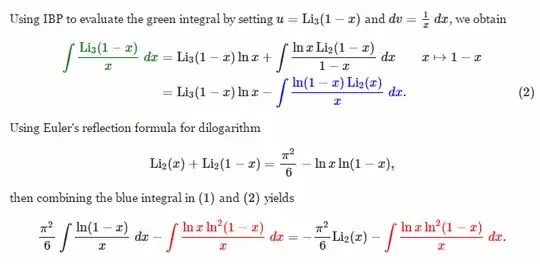

In this accepted answer, @Tunk Fey proved the above. (See $(4)$). However, I have the following $3$ queries :
  • Why can we add the integrals after the substitution $x \mapsto 1-x$ in the following step? I doubt it since $\int f(x) \ \mathrm{d}x \neq \int f(1-x) \ \mathrm{d}x$ in general.
  • Why do we omit the constant of integration in the following step? We should add the constant since it will affect the summation.
$$\begin{align} \color{red}{\int\frac{\ln x\ln^2(1-x)}{x}\ dx}&=-\int\frac{\ln (1-x)\ln^2 x}{1-x}\ dx\\ &=\int\sum_{n=1}^\infty H_n x^n\ln^2x\ dx\\ &=\sum_{n=1}^\infty H_n \int x^n\ln^2x\ dx\\ &=\sum_{n=1}^\infty H_n \frac{\partial^2}{\partial n^2}\left[\int x^n\ dx\right]\\ &=\sum_{n=1}^\infty H_n \frac{\partial^2}{\partial n^2}\left[\frac {x^{n+1}}{n+1}\right]\\ &=\sum_{n=1}^\infty H_n \left[\frac{x^{n+1}\ln^2x}{n+1}-2\frac{x^{n+1}\ln x}{(n+1)^2}+2\frac{x^{n+1}}{(n+1)^3}\right]\\ &=\ln^2x\sum_{n=1}^\infty\frac{H_n x^{n+1}}{n+1}-2\ln x\sum_{n=1}^\infty\frac{H_n x^{n+1}}{(n+1)^2}+2\sum_{n=1}^\infty\frac{H_n x^{n+1}}{(n+1)^3}\\ &=\frac12\ln^2x\ln^2(1-x)-2\ln x\left[\sum_{n=1}^\infty\frac{H_{n+1} x^{n+1}}{(n+1)^2}-\sum_{n=1}^\infty\frac{x^{n+1}}{(n+1)^3}\right]\\&+2\left[\sum_{n=1}^\infty\frac{H_{n+1} x^{n+1}}{(n+1)^3}-\sum_{n=1}^\infty\frac{x^{n+1}}{(n+1)^4}\right]\\ &=\frac12\ln^2x\ln^2(1-x)-2\ln x\left[\sum_{n=1}^\infty\frac{H_{n} x^{n}}{n^2}-\sum_{n=1}^\infty\frac{x^{n}}{n^3}\right]\\&+2\left[\sum_{n=1}^\infty\frac{H_{n} x^{n}}{n^3}-\sum_{n=1}^\infty\frac{x^{n}}{n^4}\right]\\ &=\frac12\ln^2x\ln^2(1-x)-2\ln x\left[\sum_{n=1}^\infty\frac{H_{n} x^{n}}{n^2}-\operatorname{Li}_3(x)\right]\\&+2\left[\sum_{n=1}^\infty\frac{H_{n} x^{n}}{n^3}-\operatorname{Li}_4(x)\right]. \end{align}$$

(Tunk Fey:) Dividing (1) by $x$ and integrating gives \begin{align*} \sum_{n=1}^\infty \frac{H_nx^n}{n^3} &=\zeta(3)\ln x+\frac12\color{red}{\int\frac{\ln x\ln^2(1-x)}{x}\ dx}+\color{blue}{\int\frac{\ln(1-x)\operatorname{Li}_2(1-x)}x\ dx}\\&+\operatorname{Li}_4(x)-\color{green}{\int\frac{\operatorname{Li}_3(1-x)}x\ dx}\tag{2} \end{align*}
The next step is to simplify \begin{align*} \color{green}{\int\frac{\operatorname{Li}_3(1-x)}x\ dx} \end{align*}
He continues with (question marks emphasis mine)
(Tunk Fey:) Using IBP to evaluate the green integral by setting $u=\operatorname{Li}_3(1-x)$ and $dv=\frac1x\ dx$, we obtain
\begin{align*} \color{green}{\int\frac{\operatorname{Li}_3(1-x)}x\ dx}&=\operatorname{Li}_3(1-x)\ln x+\int\frac{\ln x\operatorname{Li}_2(1-x)}{1-x}\ dx\qquad x\mapsto1-x\\ &\stackrel{???}{=}\operatorname{Li}_3(1-x)\ln x-\color{blue}{\int\frac{\ln (1-x)\operatorname{Li}_2(x)}{x}\ dx}.\tag{3} \end{align*}
OP: Why can we add the integrals after the substitution $x \mapsto 1-x$ in the following step? I doubt it since $\int f(x) \ \mathrm{d}x \neq \int f(1-x) \ \mathrm{d}x$ in general.
The substitution $x\mapsto 1-x$ is not valid in Tunk Fey's answer. We can use it e.g. in case of definite integrals by also respecting the limits of the integral. But as OP claimed in general is the substitution not admissible.
We can evalute these expressions using integration by parts to better see the difference. With $u=\frac{\ln x}{1-x}$ and $dv=\operatorname{Li}_2(1-x)dx$ we obtain \begin{align*} \int\frac{\ln x\operatorname{Li}_2(1-x)}{1-x}=\frac{1}{2}\operatorname{Li}_2^2(1-x)+C_1 \end{align*} On the other hand with $u=\frac{\ln (1-x)}{x}$ and $dv=\operatorname{Li}_2(x)dx$ we obtain for the substituted integral (3) \begin{align*} -\int\frac{\ln (1-x)\operatorname{Li}_2(x)}{x}=\frac{1}{2}\operatorname{Li}_2^2(x)+C_2\tag{4} \end{align*} with $C_1, C_2$ constants of integration.

With this incorrectly substituted expression (3) Tunk Fey obtains from (2)
\begin{align*} \sum_{n=1}^{\infty}\frac{H_nx^n}{n^3}&=\zeta(3)\ln(x)+\frac{1}{2}\int\frac{\ln x\ln^2(1-x)}{x}\ dx\\ &\qquad+\int\frac{\ln(1-x)\operatorname{Li}_2(1-x)}{x}\ dx+\operatorname{Li}_4(x)\\ &\qquad-\operatorname{Li}_3(1-x)\ln x+\int\frac{\ln(1-x)\operatorname{Li}_2(x)}{x}\ dx \end{align*}
The next step is to combine $\int\frac{\ln(1-x)\operatorname{Li}_2(1-x)}{x}\ dx$ and $\int\frac{\ln(1-x)\operatorname{Li}_2(x)}{x}\ dx$ with the help of the Euler's reflection formula \begin{align*} \operatorname{Li}_2(x)+\operatorname{Li}_2(1-x)=\frac{\pi^2}{6}-\ln x\ln(1-x) \end{align*}
He obtains \begin{align*} \sum_{n=1}^{\infty}\frac{H_nx^n}{n^3}&=\zeta(3)\ln(x)+\frac{1}{2}\int\frac{\ln x\ln^2(1-x)}{x}\ dx +\operatorname{Li}_4(x)-\operatorname{Li}_3(1-x)\ln x\\ &\qquad+\int\frac{\ln(1-x)\left(\frac{\pi^2}{6}-\ln x\ln(1-x)\right)}{x}\ dx\\ &=\zeta(3)\ln(x)-\frac{1}{2}\int\frac{\ln x\ln^2(1-x)}{x}\ dx+\operatorname{Li}_4(x)-\operatorname{Li}_3(1-x)\ln x\\ &\qquad-\frac{\pi^2}{6}\int\frac{\ln(1-x)}{x}\ dx\\ &=\zeta(3)\ln(x)-\frac{1}{2}\int\frac{\ln x\ln^2(1-x)}{x}\ dx+\operatorname{Li}_4(x)-\operatorname{Li}_3(1-x)\ln x\\ &\qquad-\frac{\pi^2}{6}\operatorname{Li}_2(x)\tag{5} \end{align*}
The next step is to simplify $\color{red}{\int\frac{\ln x\ln^2(1-x)}{x}\ dx}$. He continues with (question marks emphasis mine)
(Tunk Fey:) Setting $x\mapsto1-x$ and using the identity $H_{n+1}-H_n=\frac1{n+1}$, the red integral becomes \begin{align*} \color{red}{\int\frac{\ln x\ln^2(1-x)}{x}\ dx}&\stackrel{???}{=}-\int\frac{\ln (1-x)\ln^2 x}{1-x}\ dx\\ &=\ldots\\ &=\frac12\ln^2x\ln^2(1-x)-2\ln x\left[\sum_{n=1}^\infty\frac{H_{n} x^{n}}{n^2}-\operatorname{Li}_3(x)\right]\\ &\qquad+2\left[\sum_{n=1}^\infty\frac{H_{n} x^{n}}{n^3}-\operatorname{Li}_4(x)\right]\tag{6} \end{align*}
The substitution (???) right at the beginning is not justified and not admissible. It will also have some influence when calculating the integration constant at the end.

OP: Is the identity even true, since putting $x=\dfrac{1}{2}$ gives a [numerically different result][2] than the correct result, as pointed out by the user @Super Abound in the comments of that answer.
Again OPs doubt is reasonable, since due to the inadmissible substitutions in (3) and (6) the integration constant $C=\frac{\pi^4}{60}$ is not correct.
Evaluating the result (8) at $x=\frac{1}{2}$ gives (with some help of Wolfram Alpha) \begin{align*} \sum_{n=1}^\infty \frac{H_n}{n^32^n}&\stackrel{???}{=}-\frac{1}{8}\ln 2\zeta{3}+\frac{1}{24}\left(\ln 2\right)^4+\frac{7\pi^4}{720}+ \operatorname{Li}_4\left(\frac{1}{2}\right)\\ &\stackrel{.}{=}1.36998 \end{align*} The RHS giving $1.36998$ is also challenged by user @SuperAbound in the comment section of Tunk Fey's answer.
The correct answer seems to be provided by @Cleo which is \begin{align*} \sum_{n=1}^\infty \frac{H_n}{n^32^n}&=-\frac{1}{8}\ln 2\zeta{3}+\frac{1}{24}\left(\ln 2\right)^4+\frac{\pi^4}{720}+ \operatorname{Li}_4\left(\frac{1}{2}\right)\\ &\stackrel{.}{=}0.55824 \end{align*} The numerical value is also stated in the answer by @MhenniBenghorbal.
The difference of the two answers $\Delta=\frac{\pi^4}{120}$ seems to be a result due to the erroneously performed substitutions.
