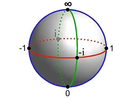

15
Riemann
Riemann
made it into a sphere:
sphere
