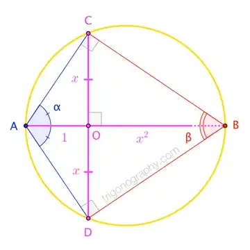

The author of the question may have been thinking purely geometrically, picturing the situation below, with $x$ the (non-negative) length of a segment:
For completeness, here's the argument one can make ...
Writing $\alpha := \angle BAC = \angle BAD$ and $\beta := \angle CBD$, we have $$\tan \alpha = x \qquad\text{and}\qquad \sin\beta = \frac{2x}{1+x^2} = \sin 2\alpha$$ (the latter by an aspect of the Law of Sines).
Certainly, $\alpha = \operatorname{atan}{x}$ for all $x$. On the other hand, $\operatorname{asin}\left(\frac{2x}{1+x^2}\right)$ is either $\beta$ or $2\alpha$, depending upon which is non-obtuse; this condition depends upon how $\alpha$ compares to $\pi/4$, which in turn depends upon how $x$ compares to $1$. Therefore, noting that opposite angles in a cyclic quadrilateral are supplementary, we can write:
$$2 \operatorname{atan} x + \operatorname{asin}\left(\frac{2x}{1+x^2}\right) \;=\; \begin{cases} 2\alpha + \phantom{2}\beta = \pi &\text{, for } x \geq 1 \\[4pt] 2\alpha + 2\alpha = 4 \operatorname{atan}x &\text{, otherwise} \end{cases}$$
Without an explicit restriction on the sign of $x$, though, you're correct: the solution to the problem stated should be $|x| \geq 1$, including negative values of $x$.
Edit. Strictly speaking, the answer cannot be $|x| \geq 1$, because then the sign of the sum in question would depend upon the sign of $x$. Perhaps the most accurate way to describe the result is:
  • The sum is constant (with value $\pi$) for $x \geq 1$.
  • The sum is constant (with value $-\pi$) for $x \leq -1$.
  • The sum is non-constant (with value $4\operatorname{atan}x$) for $-1< x < 1$.
