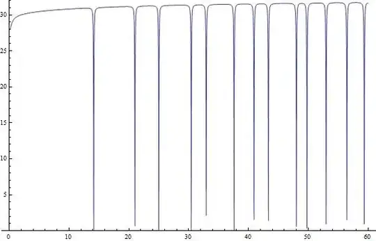

For $c$ a value close to one such as $c=1+\frac{1}{30}$ we have this plot for $\frac{\zeta (c) \zeta (\frac{1}{2}+i t)}{\zeta (c+\frac{1}{2}+i t-1)}$ on the critical line in the complex plane:
Dirichlet series spectra
where the downward spikes are at Riemann zeta zeros.
(*Mathematica 8 start*)
Clear[s, z, c]
z = 9
c = 7
N[Zeta[z]*Zeta[c]/Zeta[c + z - 1], 20]
N[Sum[Limit[
    Zeta[s] Total[1/Divisors[n]^(s - 1)*MoebiusMu[Divisors[n]]],
    s -> z]/n^c, {n, 1, 64}], 20]
Clear[c, ss, t]
ss = 30
c = 1 + 1/ss;
sigma = 1/2;
Plot[Re[N[Zeta[sigma + I*t]*Zeta[c]/Zeta[c + sigma + I*t - 1],
   20]], {t, 0, 60}, PlotRange -> {0, ss + 2}]
(*Mathematica 8 end*)
