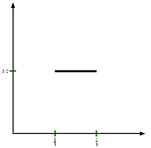

This is too long for a comment, and is not a valid counterexample if we want the equality $$F'(x)=G'(x)$$ to hold everywhere and not just almost everywhere (i.e. everywhere except a set of measure zero).
With those caveats in mind, consider the Cantor function:
(The definition is related to the Cantor set, although long enough that I don't care to post it again here.)
Except for a set of measure zero, the derivative of the Cantor function is zero, the same as any constant function. However, the Cantor function is clearly not constant, hence if we allow the derivative to be undefined except on a set of measure zero, then this is a valid counterexample.
