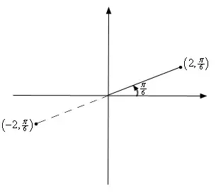

However, what does this mean for negative numbers? What is $(-1, 0^\circ)$? How do we dilate something by a factor of $-1$? One answer is that this means to go in the opposite direction. The beginning of this page has a pretty good explanation.
Effect of negative dilation factor
Now, notice what we've done here. By multiplying by $-1$, we've basically just rotated the point $180^\circ$. Therefore, we get: $$-1=(1, 180^\circ)$$ Thus, from above: $$i^2=i\cdot i=(1, 180^\circ)=-1$$
