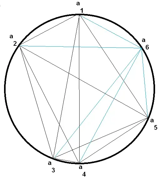

We'll assume there are no 3-way intersections for the moment. However, it seems like 2 points divide the circle into 2 areas, 3 into 4, 4 into 8, 5 into 16, and so the pattern keeps working. Here is what happens for $n=6$: Let's draw a circle with points $a_1$, $a_2$, $a_3$, $a_4$ and $a_5$. Now put $a_6$, without loss of generality, between $a_1$ and $a_5$.
  • $a_1a_6$ and $a_5a_6$ each add one section to the circle, no more. That's 2.
  • we'll also ignore any intersections with other segments inside the circle for the moment and note $a_2a_6$/$a_3a_6$/$a_4a_6$ also create at least one more section. That's 3.
  • $a_3a_6$ runs across a few lines, but which? $a_1$ and $a_2$ are on one side of it, but $a_4$ and $a_5$ are on the other. Therefore ($a_1$ or $a_2$) to ($a_4$ or $a_5$) may cross $a_3a_6$ inside the circle, but no others. That's 4.
  • $a_2a_6$ runs across a few lines too: $a_1$ and $a_3$/$a_4$/$a_5$ are on each side. Therefore $a_1a_3$, $a_1a_4$, and $a_1a_5$ all may intersect with $a_2a_6$ to create another region. That's 3.
  • $a_4a_6$ is similar to $a_2a_6$. $a_4a_6$ will intersect $a_1a_5$, $a_2a_5$, and $a_3a_5$. That's 3.
Thus the maximum number of additional regions moving from $n=5$ points to $n=6$ points is 2+3+4+3+3, or 15.
I included a diagram below to show what lines are added with a 6th point. I hope it helps you see things.
Example of 6th point added to Moser circle problem
