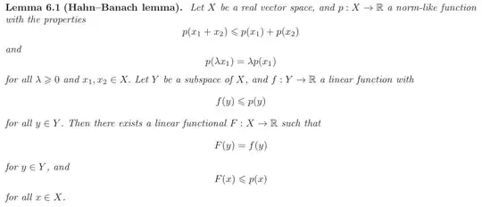

I think they do something unnecessary in my notes in the proof of the following lemma:

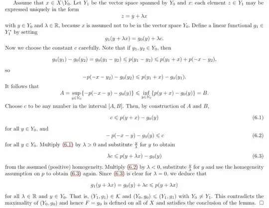

The idea of the proof is to partially order the set $\Sigma$ of pairs $(X_i, f_i)$ where $X_i$ is a linear subspace of $X$ containing $Y$ and $f_i : X_i \to \mathbb R$ is a linear map. Then apply Zorn to get a maximal element $(X^\prime, f^\prime)$ and show that $X^\prime = X$. The way to do this is by contradiction. One assumes that there is a point $z$ in $X \setminus X^\prime$ and then defines a $g$ such that $(X^{\prime \prime}, g) $ where $X^{\prime \prime} $ is spanned by $z$ and $X^\prime$ is strictly greater than $(X^\prime, f^\prime)$ in $\Sigma$, contradicting maximality.
In the notes we define $g$ in terms of $f^\prime$: If $z \in X \setminus X^\prime$ and $y \in X^{\prime \prime}$ then $g(y) = f^\prime(x^\prime) + \lambda c$ for some $\lambda$ and some $x^\prime \in X^\prime$. All we need to show is $g \leq p$. And this is the part where I think they are doing something superfluous. They pick $c \in [A,B]$ (see below) where I think it's enough to pick $c \leq B$:
If those pngs aren't readable then you can also find the proof in these notes at the very start of chapter 6. Thanks for your help.
    How do you prove (6.2) and treat the case of $\lambda \lt 0$ in (6.3) if $c \lt A$? – t.b. Aug 14 '12 at 10:13
  • @t.b. Let me see, I think I ignored the case $\lambda < 0$ in my proof! : ) Thank you! – Rudy the Reindeer Aug 14 '12 at 10:14

  • @MartinSleziak could you give me what is the argument behind the choosen interval? I don't see what's the reason behind this choice. And moreover, why should inf and sup of axtually give a closed interval. Thanks – sky90 Jul 12 '15 at 05:38
  • @sky90 I think that the proof above explains it quite well. But I will try to post some comments on this in chat. (It is better than having some longer discussion here in comments.) – Martin Sleziak Jul 12 '15 at 09:46
