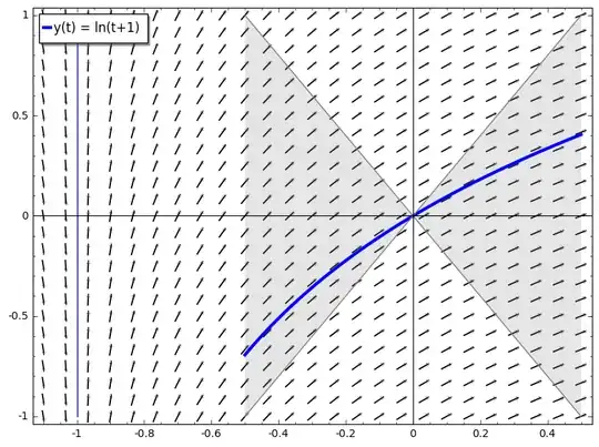

  • Consider the ODE $f(t,y) = \frac{dy}{dt} = \frac{1}{t+1}$ with initial condition $y(0) = 0$. It is not continuous at $t=-1$ (see vertical line, an integral curve that is tangent can't exist).
  • However, over the interval $t \in [-0.5, 0.5]$ it is. Therefore, it is bounded with $|f(t,y)| \leq \frac{1}{-0.5+1}=2$, and geometrically, $f(t,y) = \frac{dy}{dt}$ is the slope of any solution $y$ passing through $(0,0)$, so the solution is contained in the gray area.

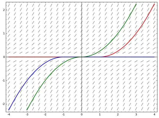

  • Consider the ODE $$f(t,y) = \sqrt{|y|}, \qquad\qquad y(0) = 0$$
  • Although continuous, the derivative $\frac{\partial f}{\partial y}$ is discontinuous, particularly infinite at $y= 0$. At least two curves will pass through $(0,0)$, i.e. $$y(t) \equiv 0 \qquad \qquad y(t) = \begin{cases}\frac{t^2}{4} \quad \mbox{if } t\geq 0\\ -\frac{t^2}{4} \quad \mbox{otherwise}\end{cases}$$
    Intuitively, the erratic transitions of the slope lines of $f(t,y)$ around $y = 0$ (due to $\frac{\partial f}{\partial y}$ being infinite) here allowed distinct integral curves (that followed different slope lines outside) to merge at y = 0. For example, for any $C \geq 0$, even $y(t) = \begin{cases}0 \qquad &\mbox{for}\ t< C\\\frac{(t-C)^2}{4} \qquad &\mbox{for} \ t\geq C \end{cases}$ or other combinations are solutions.
