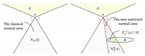

The definition of VI says that $\langle F(x),x-x^*\rangle \geq 0$. Where F is some function from $C \rightarrow R^n$, C is a convex set; $x,x^* \in C$.The more general definition of VI is called varitional condition defined as: \begin{equation} 0 \in F(x) + N_C(x) \end{equation} where $N_C(x)$ is normal cone of the set C at $x$ shown below (set C replaced by A) enter image description here
Mathematically, normal cone is defined as: \begin{equation} N_C(x) =\{d: \langle d,x-x^*\rangle\ \geq 0\quad \forall x^* \in C\} \end{equation}
When set $C= R^n_+$, then VI is called complementarity condition of the function $F$. To see this,let $F(x)=y=(y_1,y_2,...,y_n)$ and $x=(x_1,...,x_n)$. Now, generalized VI definition says that $0 \in y + N_{R^n_+}(x) \implies -y_i \in N_{R_+}(x_i) \forall i$. This means that $v_i =0$ when $x_i>0$ and $v_i \geq 0$ when $x_i =0$. Use the definition of normal cone above to have intuition why above is true.
Now, you have all the material of complementarity condition that says that the two vectors over which you are optimizing must be orthogonal. Here you have shown that $x$ and $y$ are orthogonal, i.e. $x^Ty = 0$.
