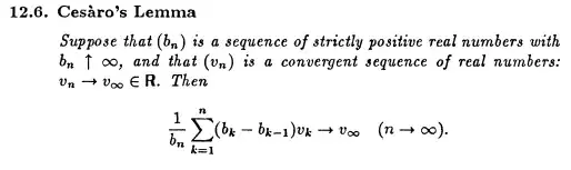

Probability with Martingales:
From Wiki:
What is their relationship? Does any imply the other?
BCLC
  • 14,197
It looks like I can prove Stolz–Cesàro theorem from Cesàro's lemma.

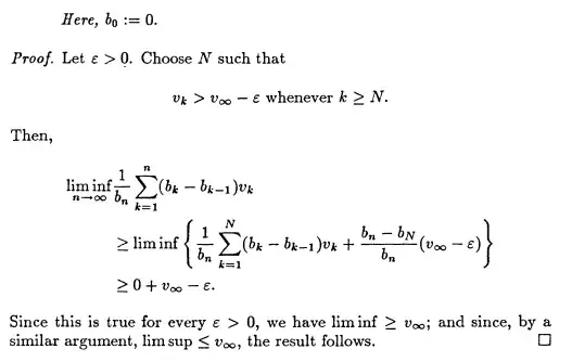

By Cesàro's Lemma, we have
$$\lim \frac{1}{b_n} \sum_{k=1}^{n} \frac{(b_k - b_{k-1})(a_k - a_{k-1})}{b_k - b_{k-1}} = v_{\infty}$$
$$\to v_{\infty} = \lim \frac{1}{b_n} \sum_{k=1}^{n} (a_k - a_{k-1})$$
$$\to v_{\infty} = \lim \frac{1}{b_n} (a_n - a_0)$$
$$\to v_{\infty} = \lim \frac{a_n}{b_n} - \lim \frac{a_0}{b_n}$$
$$\to v_{\infty} = \lim \frac{a_n}{b_n}$$
QED
