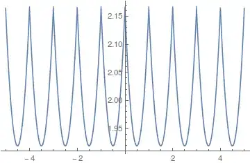

This is not an answer, just an illustration. Here is a graph of $\phi(x) = \sum_{n = -\infty}^\infty e^{-|x-n|}$ for $-5 \le x \le 5$.
Hans Engler
  • 16,092
  • This had me confused for awhile, because even though the OP asked about $n$ from $0$ to $\infty$, if $\sum_{n=-\infty}^{\infty}e^{-|x-n|}$ converged uniformly, that would imply the OP's original series converged uniformly, which I"m pretty sure it doesn't. But I think I've realized the flaw: Just because the point wise limit is periodic does not imply that the convergence is uniform. just take $f_n(x)$ a step function from $0$ to $1$ at $x=n$. This converges to a constant ( hence periodic ) function, locally uniformly, but not globally uniformly. – Callus - Reinstate Monica May 30 '16 at 17:09
