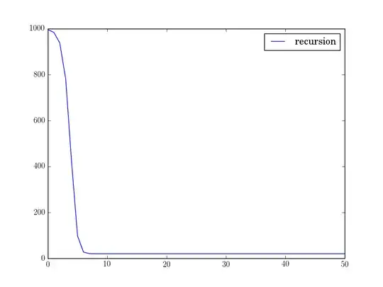

So far I've proved that this recursion converges (decreasing + bounded below), but as you can see, this function seem to converge rather fast. So my question is, how would you find either a closed form of this function, or find a bound/function such that $a(n) \leq b(n)$ for all $n$?

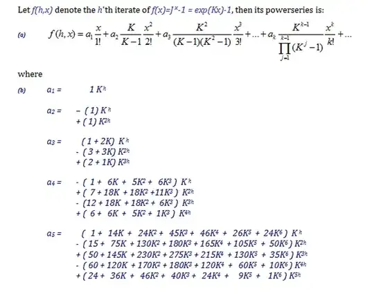

Remember that $J=\exp(K)$ or $K=\log(J)$ by my first proposal above. Then the iteration height $h=1$ gives the power series in $x$ as $$ x_1 = J^{x}-1 = Kx + (Kx)^2/2! + (Kx)^3/3! + ... \tag 2$$ For the iteration height $h=2$ we had $$x_2 = Kx_1 + (K x_1)^2/2! + (K x_1)^3/3! + ... $$ where if we expand $x_1$ into its power series (and collect $x$ of like powers) get the series $$\begin{array} {} x_2 &= K^2 x \\ &+ (1/2 K^4 + 1/2 K^3) x^2 \\& + (1/6 K^6 + 1/2 K^5 + 1/6 K^4) x^3 \\ & + O(x^4) \end{array}$$
If we try to continue for higher $h$ this we'll see that we get very complicated expressions for the coefficients at the powers of $x$. Of course we can try to find some formula for that coefficients depending on $h$ - and actually it is well known, that that coefficients are polynomials in $K$ depending on $h$.

Of course in the above derivation for $\small E_1$, $\small E_2$ we do not want the function $\small \exp(x)-1$ but $\small f(1,x) = J^x-1 = \exp(Kx)-1$ and so we have to rewrite the above formulae where the logarithm $\small K=\log(J)$ is included to get $\small F_1$, $\small F_2$, $\small F_0$ and so on to arrive at the Carleman-matrix $F$ which provides $$ V(x) \cdot F = V(J^x-1) = V(x_1) \\ V(x) \cdot F^h = V(x_h) \tag 4$$
Fractional powers of the matrix $F$ can now be found (if $\small K \ne 1$) by diagonalization: we solve for matrices $\small M,D,W$ such that $$ F = M \cdot D \cdot W \qquad M \text{ triangular }, D \text{ diagonal}, W=M^{-1} \tag 5$$ Then also $$ F^h = M \cdot D^h \cdot W \tag 6$$ and because $D$ is diagonal, fractional powers of $D$ are definable by fractional powers of the (scalar) values in the diagonal; so $$ D^h = diag (\{(d_{k,k})^h\} \tag 7$$ is well defined for positive $d_{k,k}$ (which is the case here: $\small d_{k,k}=K^k$).
In my exercises I also normalize $M$ columnwise to have ones in the diagonal (which is always possible in diagonalization) so this becomes a Carlemanmatrix too. To have now the sought interpolation for the $c(h)=x_h$ we write $$ V(x) \cdot (M \cdot D^h \cdot W) = V(x_h) $$ and because $x_h$ is in the second column of $V(x_h)$ we need only the second column of $W$ and can write $$ x_h = V(x) \cdot M \cdot D^h \cdot W[,1] \tag 8$$ This gives expanded as power series in $\small x$ and coefficients in terms of polynomials in $\small K^h$ the final form:

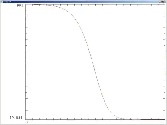

What I've got for $\small x_{0.5}$ when $\small m=1000,K=4$, $\small a(0)=m-1$ and $\small x_0 = c(0)= a(0)/m-1=-1/1000$ is
a(0)    = 999
a(0.5)  = 998.0013329778173
a(1)    = 996.0079893439915
By the construction using the diagonalization and powers of $D$ we get a series, where the parameter $h$ is in the exponent of $K$. Since we have an example, where the initial value $a(0)$ resp. $x_0$ is a constant and $k$ has a known numerical value, we can even convert that series into a power series in $h$, which makes the implementation for this function $f(h,x_0)$ in a software even simpler.
Such a (well approximated(!)) powerseries for the interpolation of $a(n)$ when $a(0)=m-1=999$ $$a(h) = ( f(h,m-1)+1 ) \cdot m = 1000 \cdot f(h,999)+1000 $$

This gives the smooth curve

  • Regarding your computation of the limit value, when I compute it with python, I get (for $m = 100$ and $K = 4$) $\sim 1.9827$. When I let the recursion go, from round 16, I get always get the same value $1.94071233282$. That's why I thought the fixed point was reached for a $N \in \mathbb{N}$. What I mean by approximating by the function, is that instead of computing it recursively, I would like to find a formula to directly compute $a(2345)$ for example, or a formula that says $a(2345) \leq b(2345, m, K)$ where $b$ is a function depending on $m$ and $K$ (maybe). – Laurent Hayez May 31 '16 at 19:32
