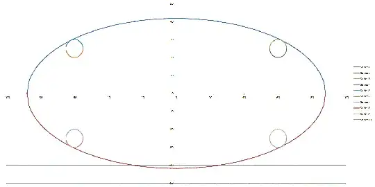

The circles are all four combinations of $(x\pm60)^2+(y\pm25)^2=5^2$ (see pic at end).
The ellipse I've got is one I found via trial and error but there must be an analytical way to solve this, right?
I looked at Find the area of largest rectangle that can be inscribed in an ellipse - and the $a=x\sqrt 2$ and $b=y\sqrt 2$ relationships seem important but I don't understand how they were derived (It seems as though many steps were omitted because it felt disjointed) nor how they could be applied to my situation.
Ellipse and Four Circles Pic

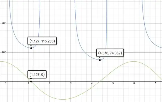

Graph of the derivative and the area
In the graph a plot of the derivative (only the sign changing part) and of the area (scaled by 100) is shown. Just to show that the minima and the zeros are aligned.

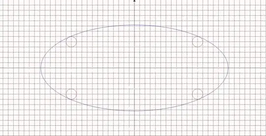

  • Wait, there is something wrong here.If $\phi$ is increased I get lower values of the area. In fact, a minimum seems to occur at $\phi = 1.12738$, the double angle of what you quoted. At this angle the area $A = 11525.27$. The corresponding values of $a$ and $b$ are $a = 87. 88$ and $b = 41.74$. – Jens May 24 '16 at 23:00
This is not an answer but an illustration of the correct ellipse based on N74's answer. It seems the OP's ellipse was in fact right on target. Below is the ellipse I get when the double of the angle given by N74 is used. The area $A = 11525.27$. Circle and ellipse2
